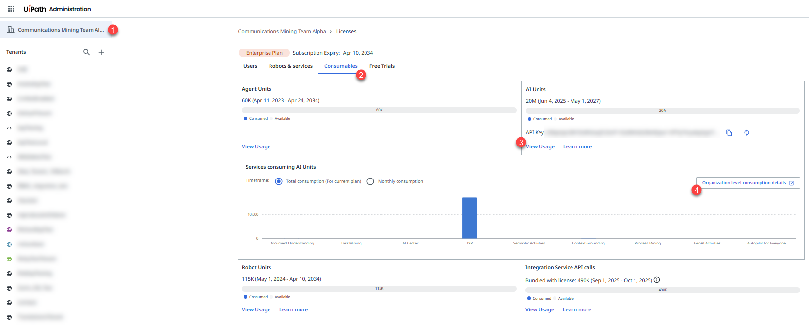

To access the AI units consumption dashboards, proceed as follows:
  1. Go to Admin in Automation Cloud™.
  2. Select the organization or a tenant to view the unit consumption at the desired level.
  3. Select Licenses.
  4. Select the Consumables tab.
  5. Select View usage under AI Units, which shows a dashboard with all services of the selected organization or tenant that consume AI Units. You can change the timeframe by selecting Total consumption or Monthly consumption.
  6. For more details, select the Organization-level consumption details or Tenant-level consumption details button. This will redirect you to the Organization level AI Unit consumption or the AI Units tenant consumption dashboards in Insights.
