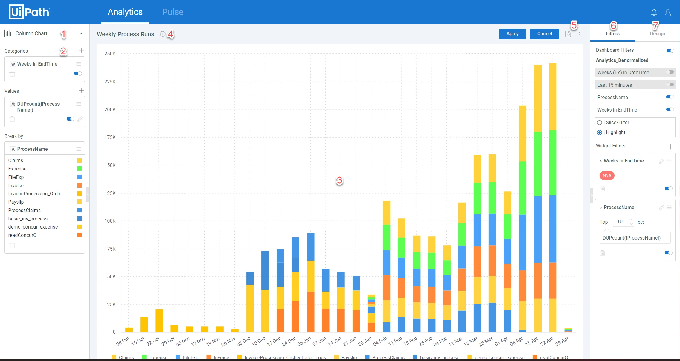

The Widget Editor
The widget editor enables you to fine tune your widget creation and design to achieve the most effective visualization for your analytical needs.
To reach the widget editor, select Advanced Configuration when creating a new widget or click the Edit Widget button of any existing widget.
Interface​
The widget editor interface contains the following features:
  1. Visualization Selector - A drop down menu enabling you to change the widget type.
  2. Data Panel - Used for selecting the values to appear in the widget and those for grouping the data. Please note that the available options differ depending on the widget type selected.
  3. Display Panel - A preview of the current design and content of the widget. If Update on Every Change is toggled in the data panel, the display updates with every changed option, otherwise it updates only when you select Update.
  4. Title - Enables you to edit the title of the widget and add an optional description.
  5. More Options - Opens a menu with the following options:
    • Save a Copy - Saves the current widget as-is and creates a copy.
    • Selection - Enables you to select whether selections made in the widget affect the dashboard filters.
    • Drill - Select whether to Enable Drill to Anywhere or not. If disabled, viewers may only drill down on the Hierarchies predefined for each value.
  6. Filter Panel - Enables you to add new widget filters or edit existing ones.
  7. Design Panel - Enables you to fine tune the widget appearance. Pleas note the available options differ depending on the widget type selected.
