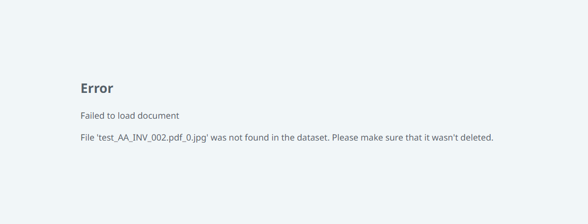

When you open a new Data Manager session or when you have an empty filter, certain guidelines are displayed in document view:
Also, loading failures are also displayed in document view:
