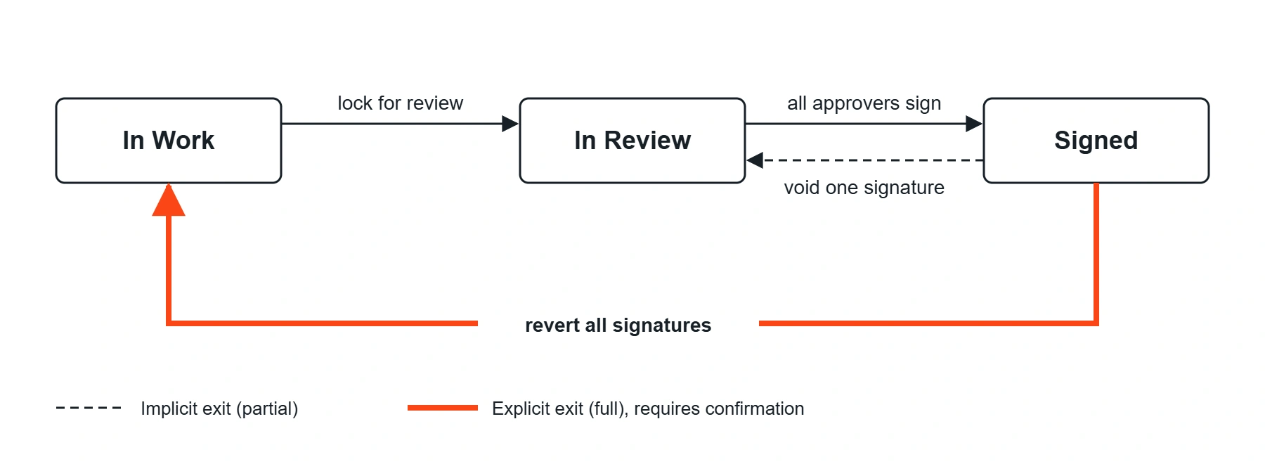

Test case logs use the same three states as test cases, In Work, In Review, Signed, and the same core terminology (Approver, Signatory Record, Approval state). For more information, refer to Testing Process Governance. However, the transitions out of the Signed state work differently for test case logs than for test cases:
- Voiding a single approver's signature on a Signed test case log implicitly reverts the log to In Review. It does not go all the way back to In Work.
- Reverting a Signed test case log all the way to In Work is a separate, explicit action that voids every signature on the log at once, and requires confirming a warning prompt.
