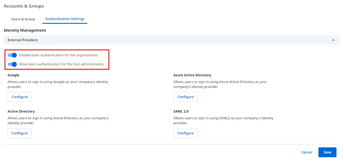

要允许或限制所有组织和所有帐户的基本身份验证,请执行以下操作:
  1. 以系统管理员身份登录到管理门户。
  2. Go to Accounts & Groups and select the Authentication Settings tab.
  3. Under External Providers, click the Disable basic authentication for the organizations toggle to restrict or allow sign in using basic authentication:
    • 如果关闭(左侧切换位置,灰色切换),则允许基本身份验证。
    • If on (right toggle position, blue toggle), basic authentication is restricted. While restricted, the Allow basic authentication for the host administrators toggle is available.
  4. If you restricted basic authentication, use the Allow basic authentication for the host administrators toggle to choose if you want to allow basic authentications for system administrators, as an exception:
    • 如果关闭(左侧切换位置,灰色切换),则系统管理员也不允许进行基本身份验证。
    • 如果打开(右侧切换位置,蓝色切换),即使不允许基本身份验证,也有例外情况,仅允许系统管理员帐户使用。
  5. At the bottom-right of the External Providers section, click Save to apply your changes.
