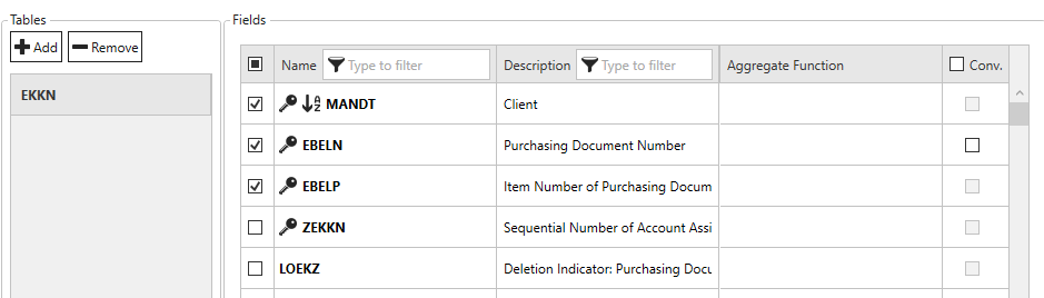

Duplicate key
When uploading data using Theobald Xtract Universal, the following error message can occur:
Possible cause
A field used for the primary key on the table is not retrived in the extraction.
Solution
To solve this, you need to check if all the fields used for the primary key on the table are retrieved in the extraction.
The following illustration shows an example from the EKKN table. For this table, the primary key is not complete, because the field ZEKKN is not retrieved. The issue can be fixed by making sure this field is also used in the extraction.
Primary keys in SAP tables can be recognized by the key symbol displayed in front of the field name.
