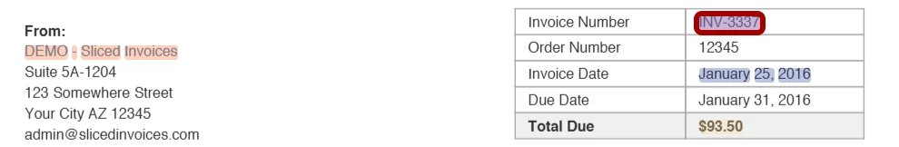

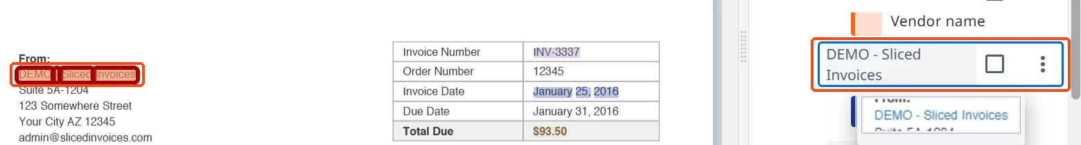

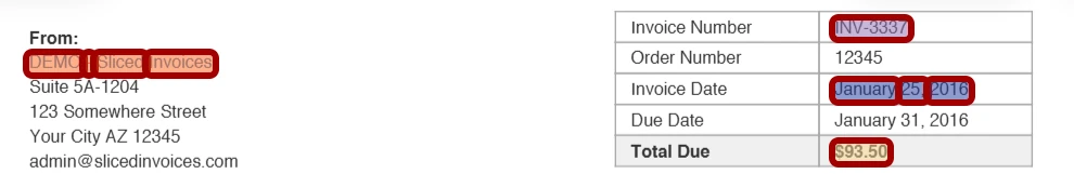

In the annotation view, each extracted value is highlighted in the document with the color of its field, as shown next to the field name in the annotation panel. Extracted values are highlighted as follows:
  • Filled - Extracted values. The fill is the same for confirmed and unconfirmed values. To check whether a value is confirmed, use its checkbox in the annotation panel: the checkbox is selected for confirmed values and cleared for unconfirmed values.
  • Solid border - The selected value. When you select a value in the annotation panel, its highlight in the document gets a solid border.

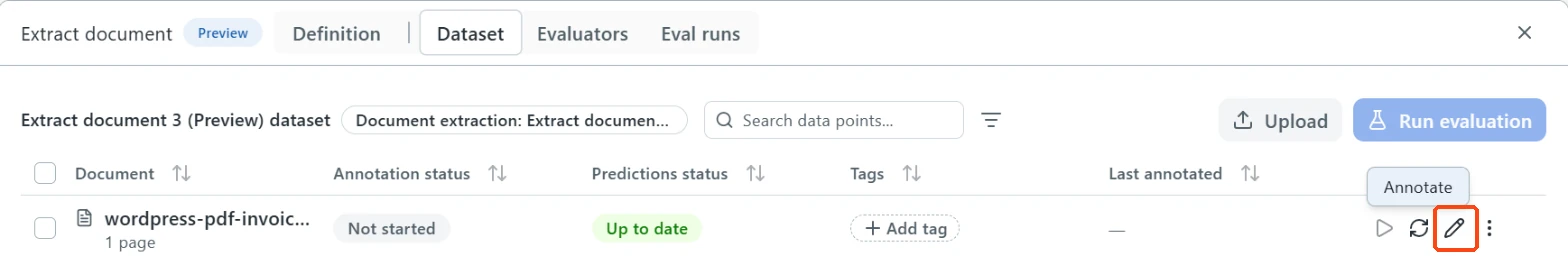

  1. Hover over the Flow Extract node, and select Open full view.
  2. In the Dataset tab, select Annotate for the document you want to validate. The model highlights the relevant span of text in the document and displays the generated predictions in the annotation panel. Values that are applicable to multiple instances of a field group, such as account number, have arrow buttons to help navigate to relevant sections. The buttons appear when you point to the values.

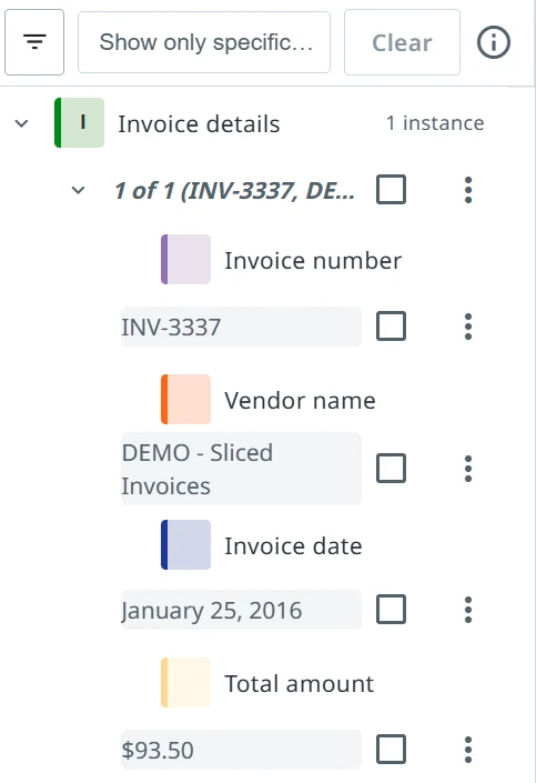

  3. Review the predictions and confirm the extracted values in one of the following ways:
    • To confirm a single value, select its checkbox.
    • To confirm an entire field group row, select the row checkbox.

Predicted values​

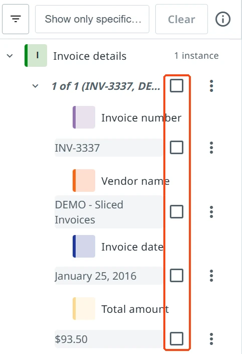

Unconfirmed values​
No values are marked as confirmed:
Figure 1. Unconfirmed values

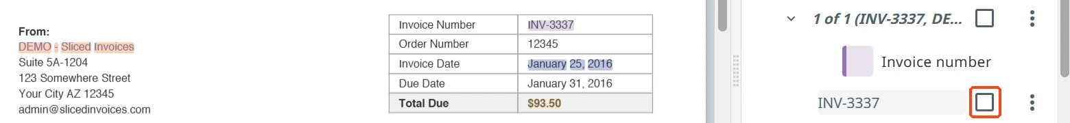

Confirmed​
References are highlighted with a solid border:
Figure 2. Confirmed reference

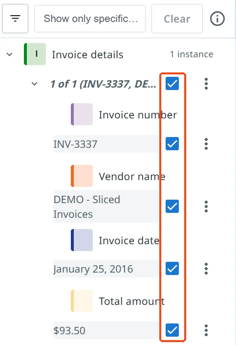

Values are marked as confirmed:
Figure 3. Confirmed values

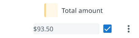

When the annotation matches the prediction, the value looks as follows:
Figure 4. Correct prediction

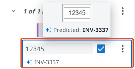

When the annotation does not match the prediction, the value looks as follows:
Figure 5. Incorrect prediction
Note:
Predictions are compared to annotations, not the references. References might be missing or incorrect, but this will not be flagged as a mismatch.

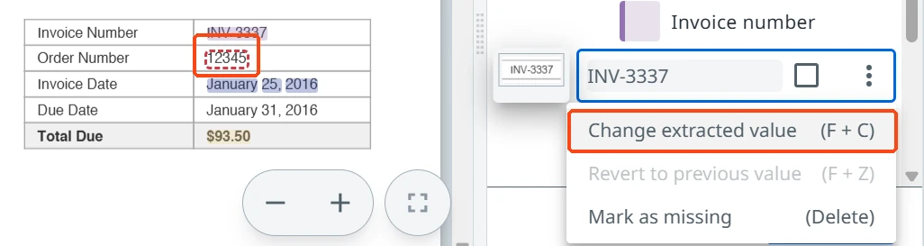

Annotating the expected value​
When a predicted value is incorrect, annotate the expected value. The annotation sets the ground truth, the true expected value, that evaluation runs compare the predictions of the model against. It does not change the model or its future predictions.
To annotate the expected value, proceed as follows:
  1. In the annotation panel, select the ellipsis for the field, and then select Change extracted value. For a field without a value, which shows Is missing, select the plus icon.
  2. Highlight the correct value in the document.

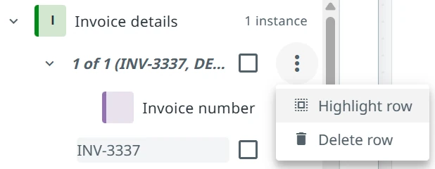

  3. Select the ellipsis for a field group row to use one of the following options:
    • Highlight row
    • Delete row
  4. Confirm the values by selecting the checkbox of each value or field group row.
