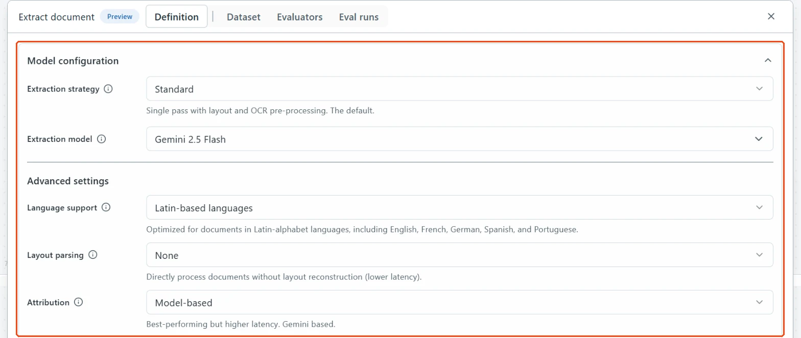

Configuring the model​
You can configure the underlying LLM as well as its settings in the Model configuration section of the Definition tab as follows:
  1. In the Flow canvas, hover over the Extract node.
  2. In the toolbar that appears, select Open full view. The Definition tab opens.
  3. Expand Model configuration.
  4. From the Extraction strategy dropdown list, select the extraction method used to understand and process the document:
    • Standard - The default option. Processes the document in a single pass, with layout and OCR pre-processing.
    • Advanced - Splits the document across multiple passes, with layout and OCR pre-processing. This option is best suited for documents past a few hundred pages, or for documents that require a large number of field values.
    Note:
    When you select Advanced, the Attribution setting is no longer displayed.
  5. From the Extraction model dropdown list, select the underlying LLM used for extraction:
    • gpt-4o
    • gpt-5.1-2025-11-13 (preview)
    • gpt-5.4-2026-03-05 (preview)
    • Gemini 2.5 Flash
    • Gemini 2.5 Pro (preview)
    • Gemini 3.1 Pro Preview (preview)
    • Gemini 3.1 Flash Lite (preview)
    Note:
    You can run these models on your own LLM subscriptions instead of the UiPath LLM subscriptions. For details, refer to Bring your own subscription (BYOS).
  6. Optionally, under Advanced settings, from the Language support dropdown list, select Latin-based languages or Extended languages. You can also keep the Auto-detect option. For more details, refer to Language support.
  7. From the Layout parsing dropdown list, select None or Full. For more details, refer to Layout parsing.
  8. From the Attribution dropdown list, select Rules-based or Model-based. This setting is available only for the Standard extraction strategy. For more details, refer to Attribution.
  9. Optionally, if the Overrides setting is available, enter the overrides in JSON format. For more details, refer to Overrides.
  10. Select Save.
Result: The Extract node uses the new model configuration.
