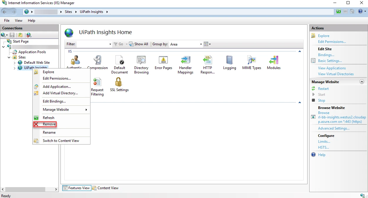

Application Pool Not Removed

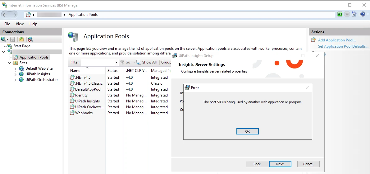

When you uninstall Insights, you can encounter the following error The port 443 (or 543) is being used by another web application or program. This can be caused by IIS or an Insight uninstall issue.
To solve this issue, open IIS and remove UiPath Insights from Sites.

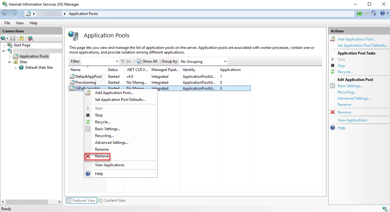

Then remove UiPath Insights and Provisioning from Application Pools.

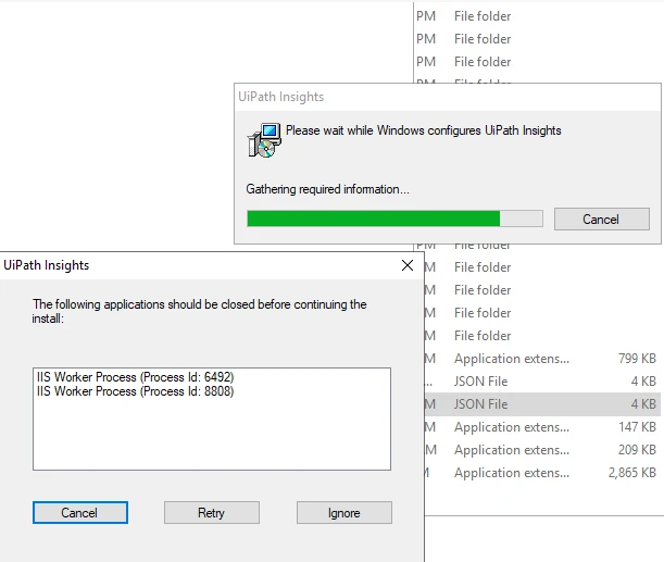

When you uninstall Insights, you can encounter the following error The following applications should be closed before continuing the install: IIS Worker Process (Process Id: 6492 and Process Id: 8808) This can be caused by w3wp.exe worker process that is still running.
To solve this issue, open the console or PowerShell and run the following command and then select Retry in the error dialog to continue Insights uninstall.
net stop was /y
net start w3svc
net stop was /y
net start w3svc
If this command is unsuccessful, you may need to restart the machine and rerun it.

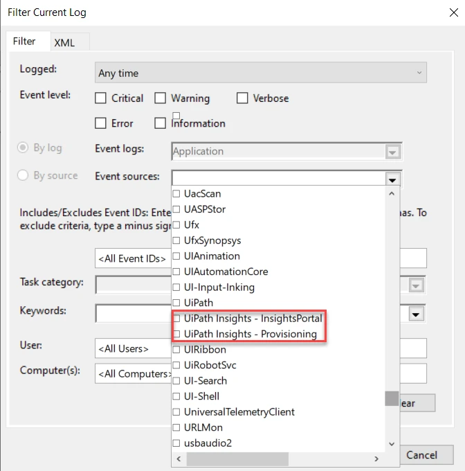

You can find the Insights Portal logs and Provision logs in Windows Event Viewer. Use the Filter Current Log option to filter by Event source.
