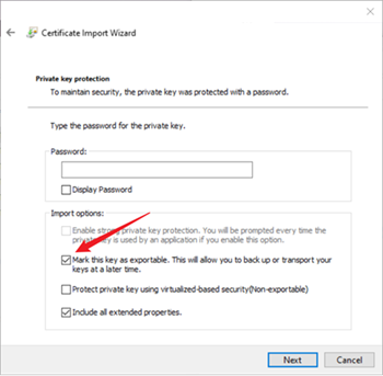

    Note:
    If you are generating a self-signed certificate for Insights manually, please make sure it is marked as exportable with the private key and imported into the Personal store.

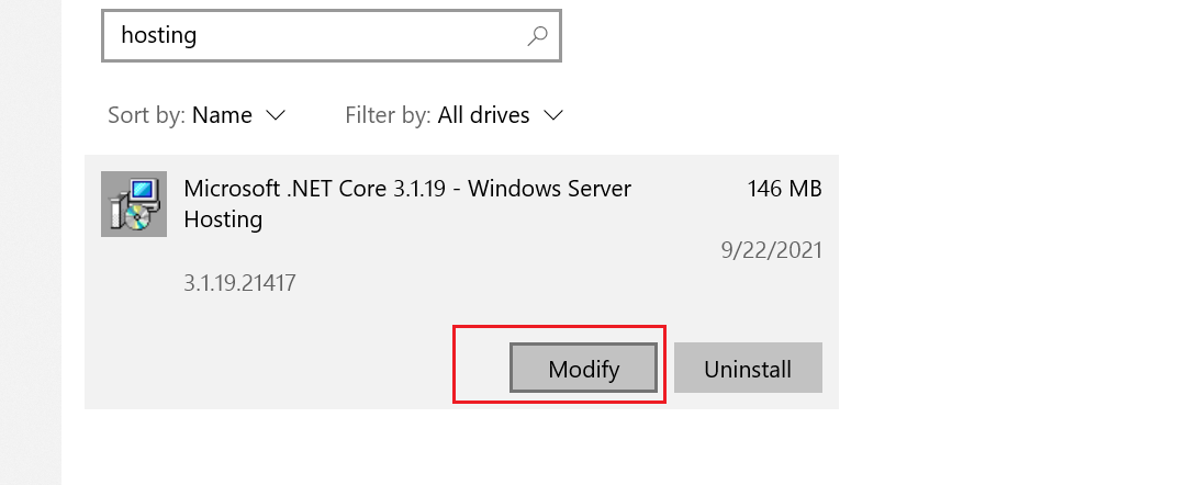

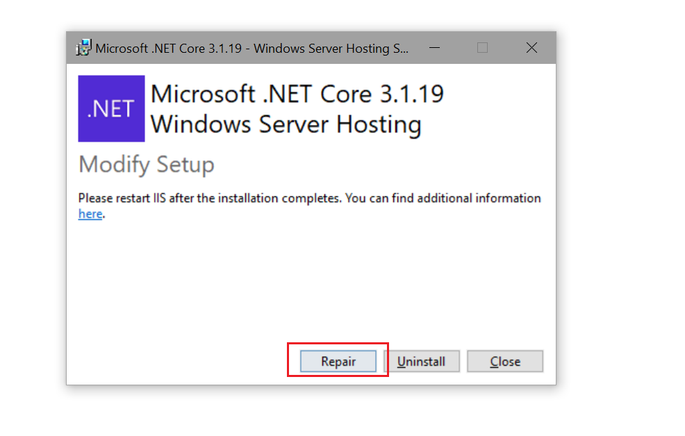

This error may occur if the IIS Hosting Bundle was not installed correctly.
To fix this issue, take the following steps:
  1. Go to Add or remove programs, search for Microsoft .NET Core, and select Modify.
  2. Select Repair in the newly open window.

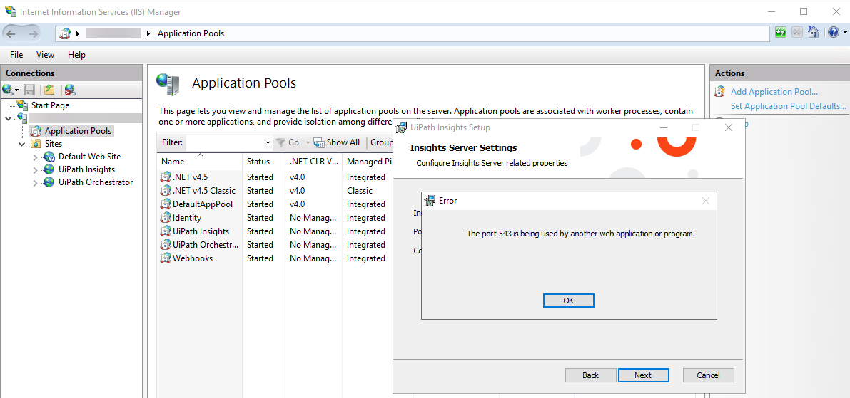

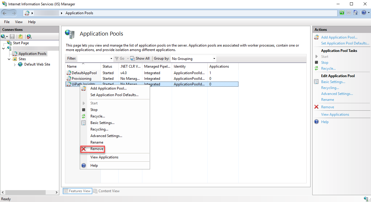

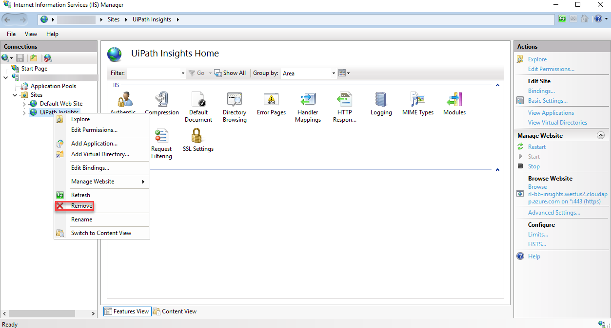

Application Pool Not Removed​
When you uninstall Insights, you can encounter the following error The port 443 (or 543) is being used by another web application or program. This can be caused by IIS or an Insight uninstall issue.
To solve this issue, open IIS and remove UiPath Insights from Sites.
Then remove UiPath Insights and Provisioning from Application Pools.

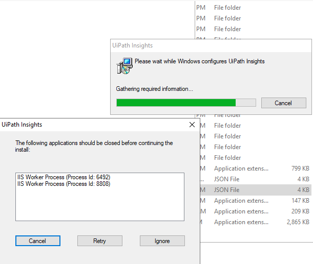

Uninstall Error Caused by Worker Process​
When you uninstall Insights, you can encounter the following error The following applications should be closed before continuing the install: IIS Worker Process (Process Id: 6492 and Process Id: 8808) This can be caused by w3wp.exe worker process that is still running.
To solve this issue, open the console or PowerShell and run the following command and then select Retry in the error dialog to continue Insights uninstall.
net stop was /y
net start w3svc
net stop was /y
net start w3svc
If this command is unsuccessful, you may need to restart the machine and rerun it.

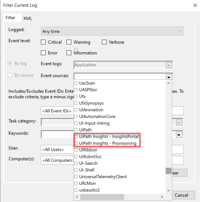

Accessing Logs​
If you performed the Insights installation, take the following steps to find the logs generated by the installer:
  • Navigate to the %temp% or %temp%/<sessionID> folder, where the <sessionID> is the integer of the session you are in. Example: %temp% or %temp%/2. The name of the log file is MSI*****.log, where the asterisks represent random letters.
  • You can find the Looker Installation logs in the %programdata% folder.
If you have upgraded to the latest version, the Looker installation logs are still located in the C:\Users\UserName_insights folder.
  • You can find the Insights Portal logs and Provision logs in Windows Event Viewer. Use the Filter Current Log option to filter by Event source.
