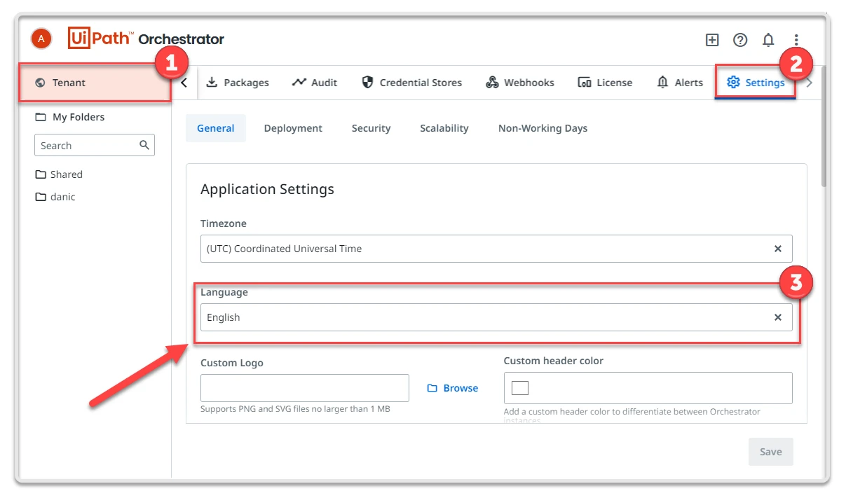

Changing the Insights Language​
Selecting the Insights language is done from the Orchestrator tenant settings. All users in that tenant share the same language.

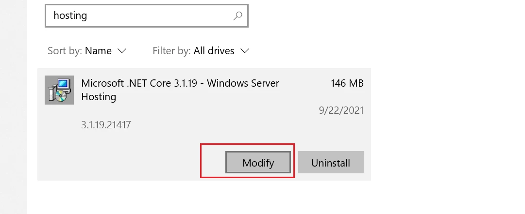

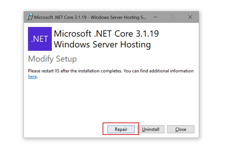

This error may occur if the IIS Hosting Bundle was not installed correctly.
To fix this issue, take the following steps:
  1. Go to Add or remove programs, search for Microsoft .NET Core, and click Modify
  2. Click Repair in the newly open window.
    Note:
    If this does not solve the issue, we recommend uninstalling and then reinstalling the IIS Hosting Bundle.
