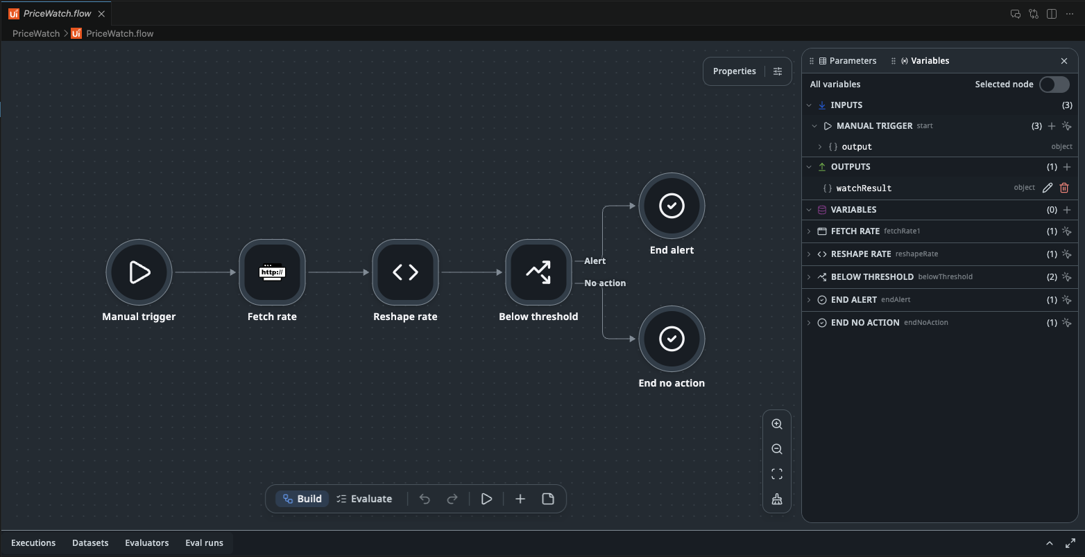

What you are building​
We are going to build the rest of the Price Watch Flow, which takes three inputs on its manual trigger and returns one object with the result based on our logic. Every node in the Flow has a single job, and the Flow connects them to create the full workflow.
Below is a text diagram of the different nodes, how they are connected, and shows details about each one's purpose:
     start              fetchRate1           reshapeRate1        belowThreshold1
│ Manual       │─────▶│ HTTP Request │────▶│ Script       │────▶│ Decision     │
│ trigger      │      │              │     │              │     │              │
 baseCurrency          GET /v2/rates        reads .body          rate below
 quoteCurrency         ?base&quotes         returns pair,        threshold?
 alertThreshold                             rate, asOf,                │
                                            belowThreshold             │
                                                           true │             │ false
                                                           endAlert1     endNoAction1
                                                          │ End      │  │ End      │
                                                           "alert"       "no action"
                                            belowThreshold             │
                                                           true │             │ false
                                                          │ End      │  │ End      │
                                                           "alert"       "no action"
Tip:
We will use the node ID values shown above by updating them for readability from the generated ones - the instructions will show you how to update each of them.
The following is the list of all the components that will make up the Flow:
ComponentDetails
Input: baseCurrencystring, default USD; the currency to price from
Input: quoteCurrencystring, default EUR; the currency to price into
Input: alertThresholdnumber, default 0.9; alert when the rate falls below this value
Output: watchResultobject with pair, rate, asOf, and belowThreshold
Node (Manual trigger): startStarts the run on demand and carries the three inputs into the flow
Node (HTTP Request): fetchRate1Sends a GET request to the Frankfurter exchange-rate API
Node (Script): reshapeRate1Reads the response body and returns pair, rate, asOf, and belowThreshold
Node (Decision): belowThreshold1Evaluates belowThreshold and takes either the true or the false path
Node (End): endAlert1Returns watchResult as an object with the values pair, rate, asOf and belowThreshold from the reshapeRate1 node
Node (End): endNoAction1Returns watchResult as an object with the values pair, rate, asOf and belowThreshold from the reshapeRate1 node

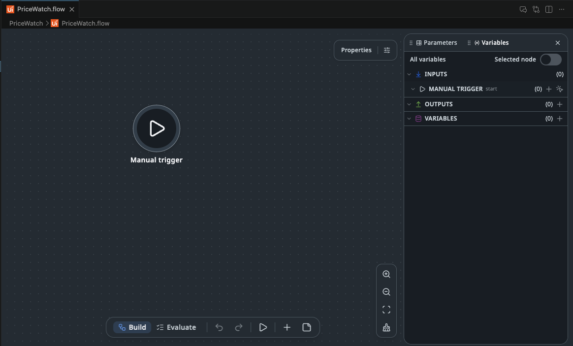

  4. Confirm that the Flow was scaffolded with a single trigger node:
    uip maestro flow node list PriceWatch/PriceWatch.flow --output table
    You should only see a single line for trigger in the output - your X and Y coordinates may differ as these change as you move nodes in the visual Canvas:
    Id              | Type                | Label           | Position
    start           | core.trigger.manual | Manual trigger  | {"X":-192,"Y":0}
  5. Open the PriceWatch/PriceWatch.flow file in VS Code. With the UiPath Maestro extension installed, the file opens on the visual canvas instead of as raw text, allowing you to see the visual representation of your workflow.
