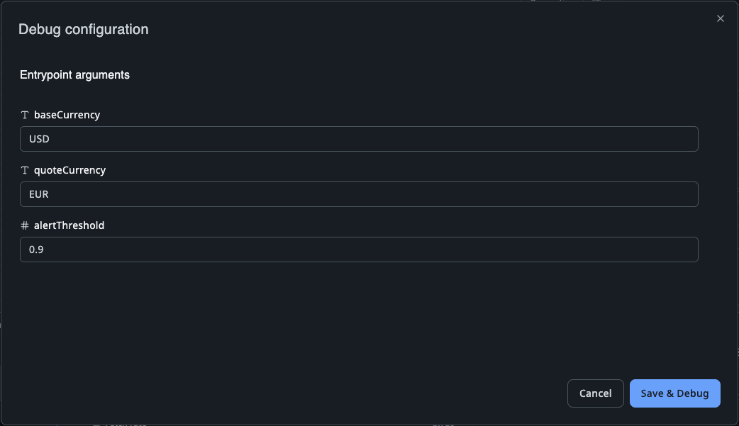

  1. Select Debug in the canvas toolbar (the play button - ▶️).
  2. Supply values for the three trigger inputs when prompted - the defaults we set earlier should be set for each one.

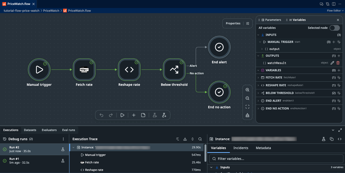

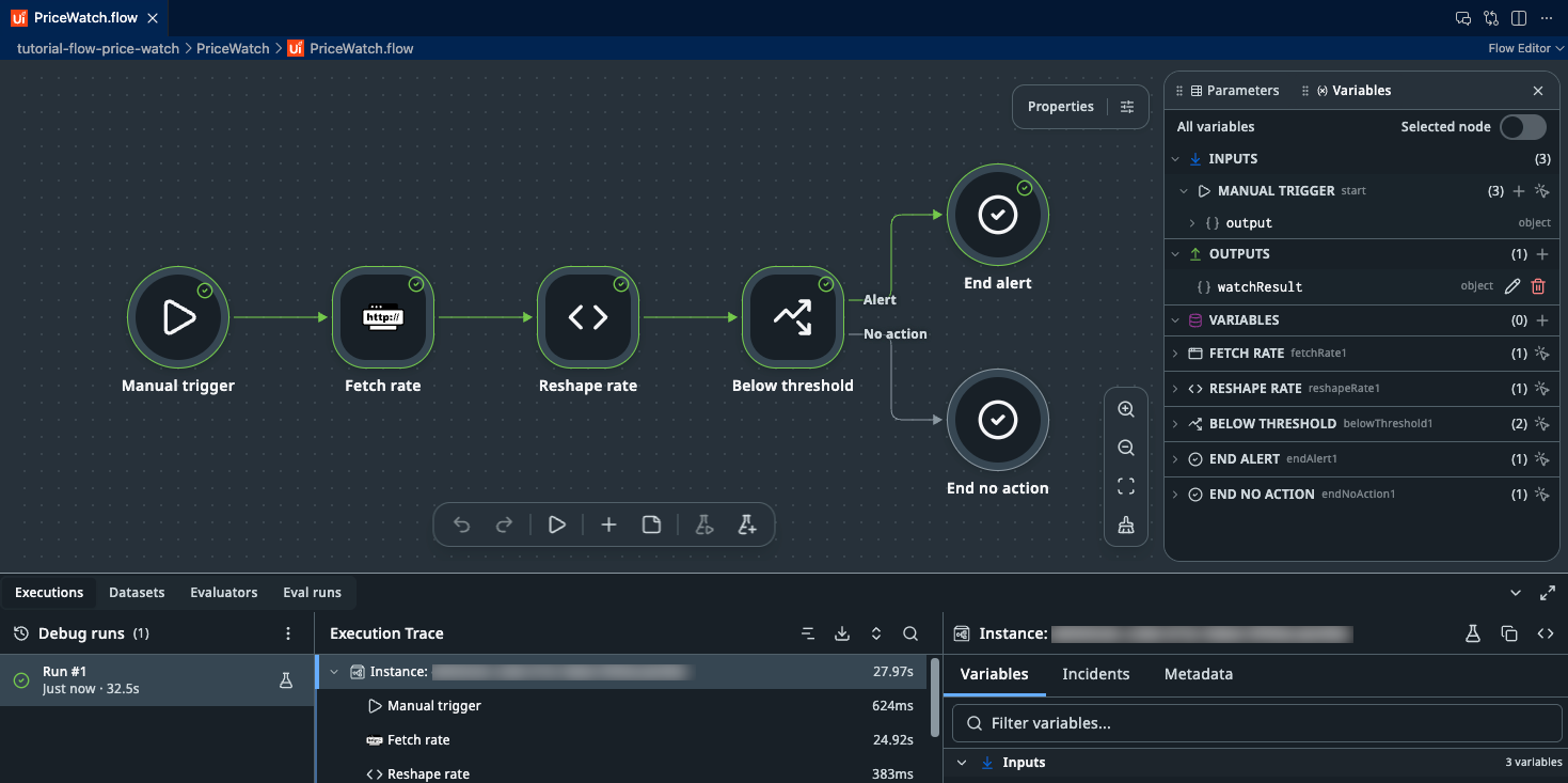

  3. Watch the execution panel at the bottom of the editor as the trace populates, node by node.
Each node shows a success or failure indicator when the run finishes. Here is what the successful execution should look like when the endAlert1 node was the end node:

Only one End node appears, which is how you confirm which branch was executed. The nested _Implicit_* entries under fetchRate1 are the managed HTTP node expanding into a subprocess.
