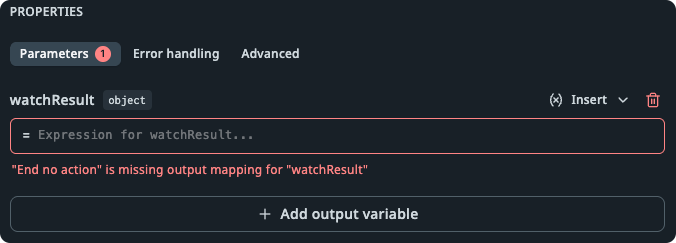

  2. MISSING_OUTPUT_MAPPING - an End node that does not set the output variable(s), and will return them with null values - any downstream system or Flow that needs them will likely error if the values are not set.
    - [nodes[endAlert1].outputs.watchResult.source] [MISSING_OUTPUT_MAPPING] "End alert"
      is missing output mapping for "watchResult"
    To fix this issue, edit the endAlert1 node and add the missing code to set the watchResult variable (refer to steps 2.5 and 2.6).
Tip:
Each End node will have one field per output variable created in the Flow. This ensures that all possible End nodes will return the same outputs, but how they are set is configured on each individual End node. A useful way to think about this is that the Trigger node's input variables and the End nodes' output variable are the contract values needed for this Flow, similar to request and response objects for an API call.
If an output mapping is not set on an End node, it will be highlighted with a red warning for "End" is missing output mapping for "<name>" when viewing the node's properties in the canvas in VS Code. That is the same warning that uip maestro flow validate shows as MISSING_OUTPUT_MAPPING.
