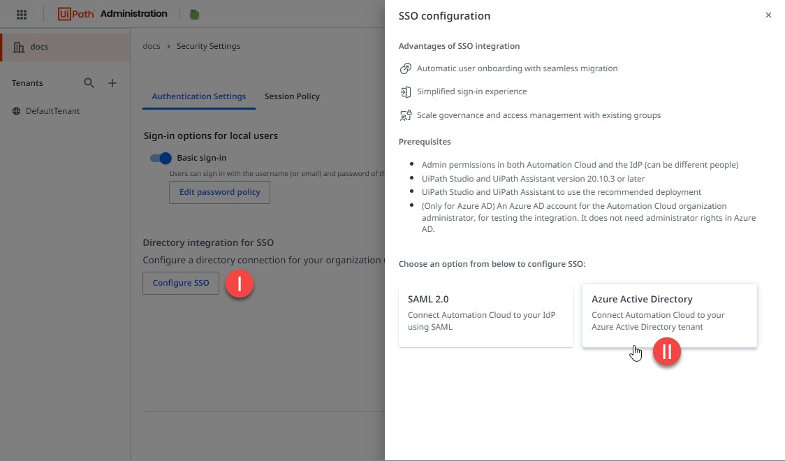

To activate the Azure AD integration, do the following in Automation Suite:
  1. Log in to your organization as an organization administrator.
  2. Go to Admin, make sure that the organization is selected at the top of the left pane, and then click Security.
    If you are still using the old admin experience, go to Admin and click Security Settings on the left.
  3. Click Configure SSO and then, in the panel that opens, click Azure Active Directory.
1124
If you are still using the old admin experience, in the External Providers section, click Configure under Azure Active Directory instead.
