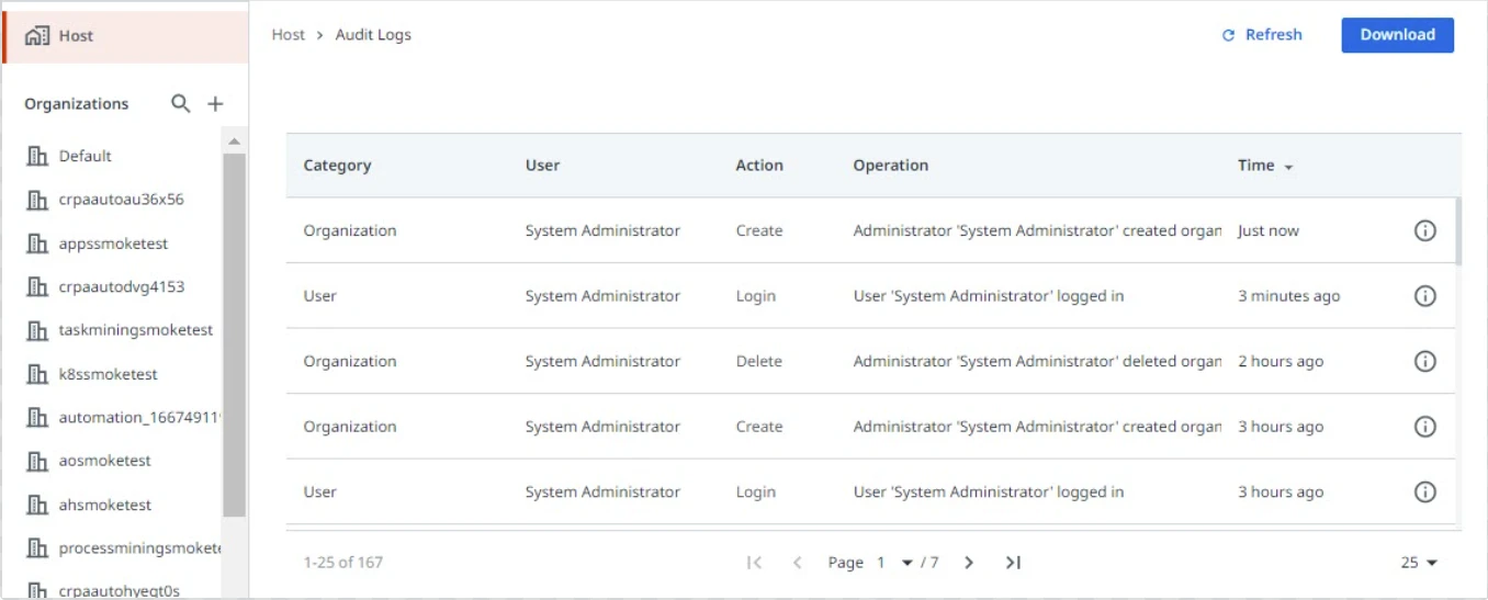

Viewing audit logs​
To view the audit logs, sign in to the host portal as a system administrator, make sure that Host is selected at the top of the left pane, and then select Audit Logs.
This page lists the actions performed by system administrators strictly within the host portal.
Select Open at the right of a row to open the Audit Data dialog and view details for that log entry:
