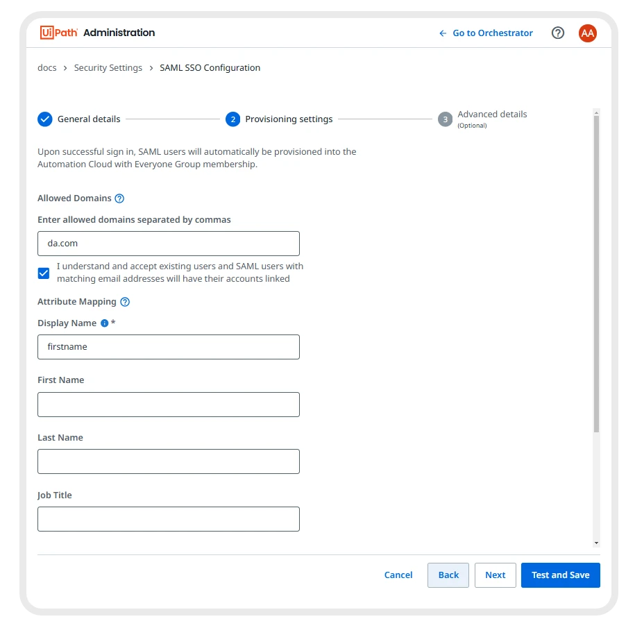

  6. Select Next in the bottom right corner to move to the next step. The Provisioning settings tab opens. Mapping attributes, referred to as "claims", link user details between your identity provider and Automation Suite. This ensures user data, like an email or username, matches across both systems.
  7. By default, the email address is used as the users' identifier. Follow these steps:
    1. Fill in the Allowed Domains section with the domains from which you want to allow users to sign in. Enter all of the domains that are supported by the configured identity provider. Separate multiple domains using commas.
    2. Select the checkbox for I understand and accept existing users and SAML users with matching email addresses will have their accounts linked to acknoweldge users are linked based on their email addresses.
    3. Under Attribute Mapping, fill in the Display Name field with the attribute from your IdP that you want to show in Automation Suite as the name for users. You can use the First Name and Last Name attributes here.
    4. Optionally, add new mappings, by specifying the respective claim from the identity provider and the corresponding attribute in Automation Suite.

Step 3. Transition your users to SAML SSO​
Make sure you provide your organization-specific URL for the Automation Suite organization to all your users.
Note:
After switching to SAML integration, the Microsoft Entra ID integration is disabled. Microsoft Entra ID group assignments no longer apply, so Automation Suite group membership and the permissions inherited from Microsoft Entra ID are no longer respected.
To sign in to Automation Suite with SAML SSO, users can:
  • navigate to your organization-specific URL. The URL must include the organization ID and end in a forward slash, such as https://{yourDomain}/orgID.
  • navigate to https://{yourDomain}, select Continue with SSO on the Login page, then provide their organization-specific URL.
To sign in to UiPath Studio and UiPath Assistant using SAML SSO, users must configure Assistant as follows:
  1. In Assistant, open Preferences and select the Orchestrator Connection tab.
  2. Select Sign Out.
  3. For the connection type, select Service URL.
  4. In the Service URL field, add the organization-specific URL.
    The URL must include the organization ID and end in a forward slash, such as https://{yourDomain}/orgID. Otherwise, the connection fails saying that the user does not belong to any organization.
  5. Sign back in with SAML SSO.
Step 4. Configure permissions and robots​
This is only required for new users who have not used Automation Suite before and therefore did not have a local account set up for them in Automation Suite when the integration was enabled.
You can add new users to Automation Suite groups by their email address (as used in the external IdP). Once a user has been assigned to a group or they have signed in, they will be available through search for role assignment across all UiPath services.
Step 5. Discontinue use of local accounts (optional)​
Warning:
Make sure all users have signed in with their SSO account at least once before you remove their local accounts. Account linking only occurs at the first SSO sign-in. If a local account is deleted before the user signs in via SSO, a new directory identity is created instead - the user loses access to their previous work, including projects and solutions. This cannot be reversed.
After all users have transitioned to SAML SSO and new users are set up, we recommend that you remove all local user accounts that are not administrator accounts. This ensures that users can no longer sign in with their local account credentials and they have to sign in with SAML SSO.
You can identify local user accounts based on their icons.
A local account can be useful:
  • To manage SAML integration issues (e.g., updating an expired certificate) or if changing authentication settings - an account with the organization administrator role is recommended.
Troubleshooting​
If you are getting the error User login failed. (#216), it may be due to missing email address mapping in the configuration of the SAML identity provider.
The SAML claim must be named http://schemas.xmlsoap.org/ws/2005/05/identity/claims/emailaddress (case sensitive) and the value must have a valid email address.
