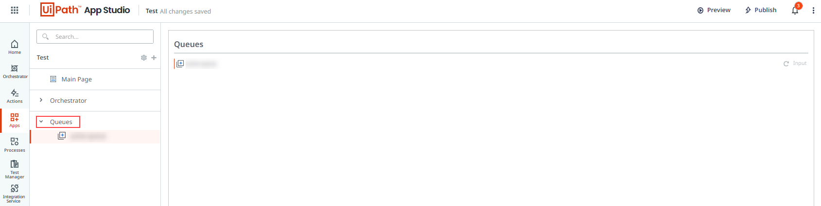

Updating a Referenced Queue
If there are any changes made to a queue schema, follow the steps bellow to update it in Apps.
  1. Once a queue is referenced, select it from the Queues menu in Apps.
  2. Select the queue from the list.
  3. Click on the Refresh icon.
