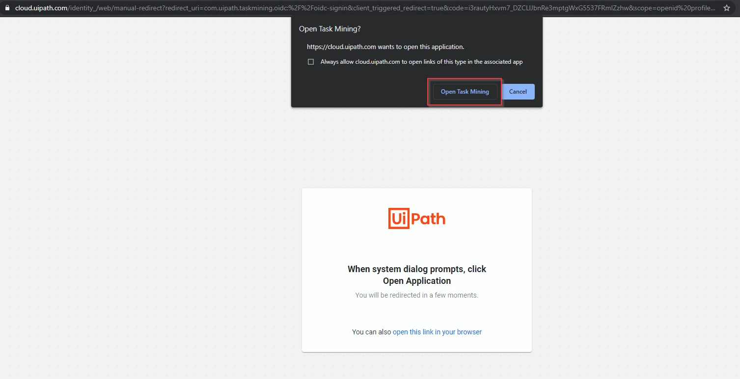

When the desktop client is launched for the first time, you're asked to sign in. To do so, follow the steps below:
  1. Select Sign In and a browser page opens up where you might be asked to log in using your credentials, or if already on the Task Mining page, the Task Mining client will automatically log in with your credentials.
  2. Select the desired tenant for which you wish to record and select Continue. If you have multiple tenants, select the appropriate one from the Tenant drop-down list.

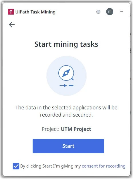

  3. Prepare the capturing environment at this moment to avoid recording irrelevant screenshots - just close the apps that you're not going to use as part of your task.
    Check out the instructions for recording displayed on the consent screen, and prepare the capturing environment accordingly to avoid recording irrelevant screenshots - just close the apps that you're not going to use as part of your task.
    Note:
    Ensure you give consent to record your actions by checking the checkbox above the Start button.

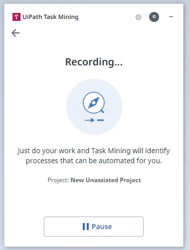

  • The status of the recording application: this can be either Stopped or Started and can be changed only by the Administrator or Project Administrator from the Admin Console.
  • The Pause option: use it to pause the recording for a maximum of 1 hour.
    This is helpful when you want to avoid capturing personal data or something that might increase noisiness in recorded data.
