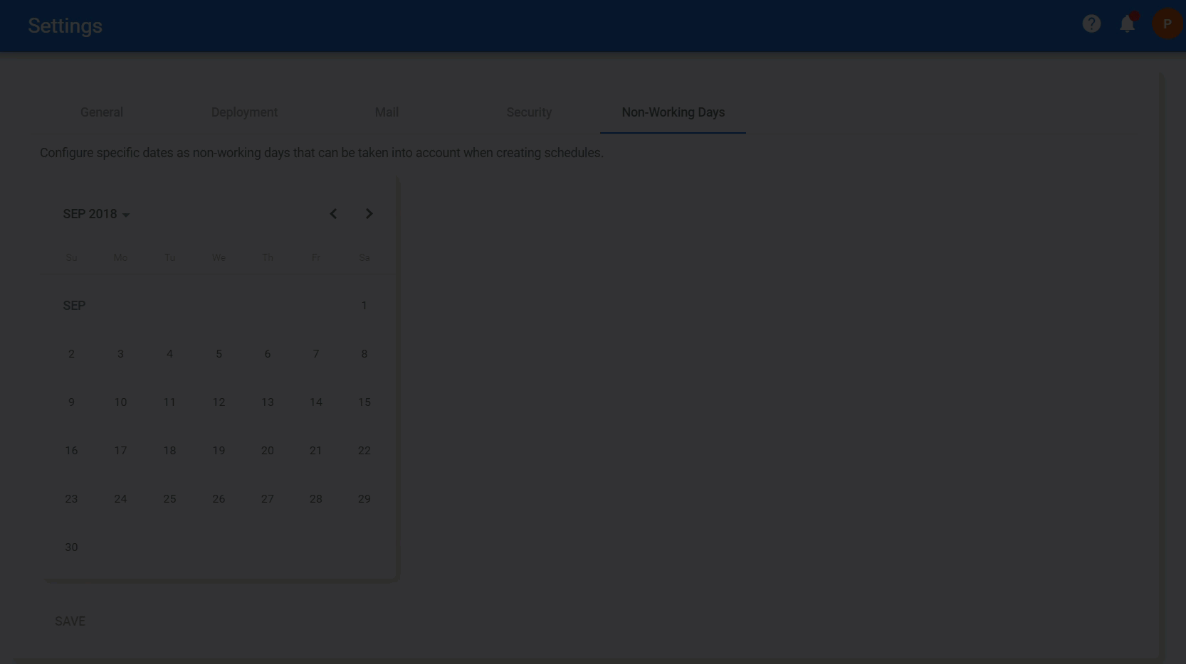

Defining Non-Working Days
  1. Open the Non-Working Days tab on the Settings page.
  2. On the displayed calendar click the dates on which you want your schedules to stop triggering.
  3. Click Save.

Removing Non-Working Days
  2. On the displayed calendar click the non-working days that are already configured. Note that they are no longer marked as non-working days.
  3. Click Save for your changes to take effect.
