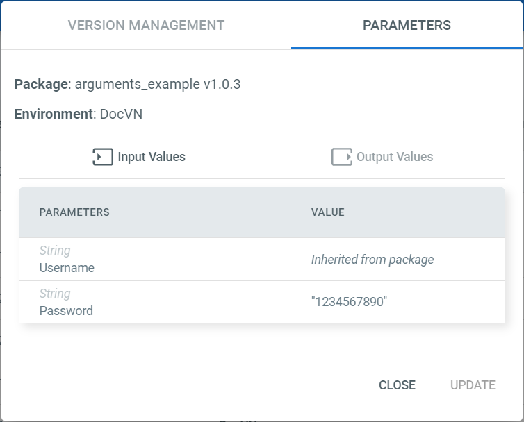

  2. Open the View Process window. At this level, you can edit the value of the input parameters, be it inherited from Studio or not.
  3. Change the value of the Password argument to 1234567890, for example. The value is displayed as such in the View Process window.
754754
  1. Click Update. The new value for the input parameter is saved.
