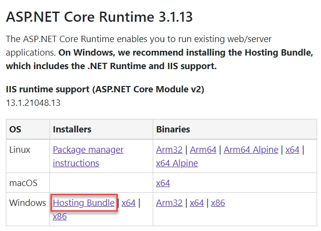

  • ASP.NET Core IIS Module - minimum version 3.1.x available here, 5.0.x available here, or 6.0.x available here. It is available as part of the Hosting Bundle. To download it, make sure you click Hosting Bundle, as shown in the following image.
    Note:
    Only the Core module is required, and can be installed without any runtimes by using the OPT_NO_RUNTIME=1 parameter from the command line.
