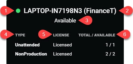

All the runtimes on one machine template are grouped together in one entry for each workstation that is connected to Orchestrator. The different blocks represent each such host machine. Hovering over each block displays an overview of that workstation:
| Field | Description |
| 1 | The name and status of the host machine. See below a breakdown of the host machine statuses. |
| 2 | The name of the machine template used to connect the workstation to Orchestrator |
| 3 | The status of the machine. They are detailed in the table below. |
| 4, 5, 6 | The type of each runtime, their licensing status, the total number of runtimes for each type, and the available runtimes of the total. |
