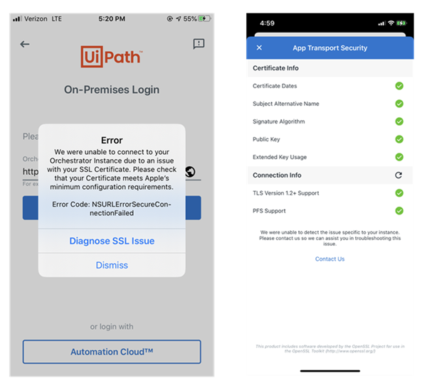

While connecting to your Orchestrator instance using the Orchestrator app on a iOS mobile device, you may run into an SSL or ATS certification issue.
The procedure below helps you to resolve this issue by installing and trusting the root SSL certificate directly to your iOS mobile device.

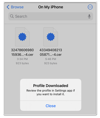

You can send the .CER file to your iOS mobile device. Tapping on the received file starts the certificate download. You are prompted by the following message:
