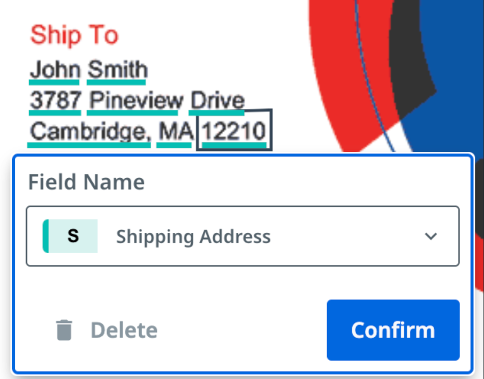

In the following image, the Shipping Address has been incorrectly predicted to include the person's name.
To fix this, you only need to confirm the Shipping Address. It's not necessary to remove the underlined text related to the name. As you continue with your annotation and correct such errors, the occasions when the underlined text doesn't align with the confirmed field should decrease.

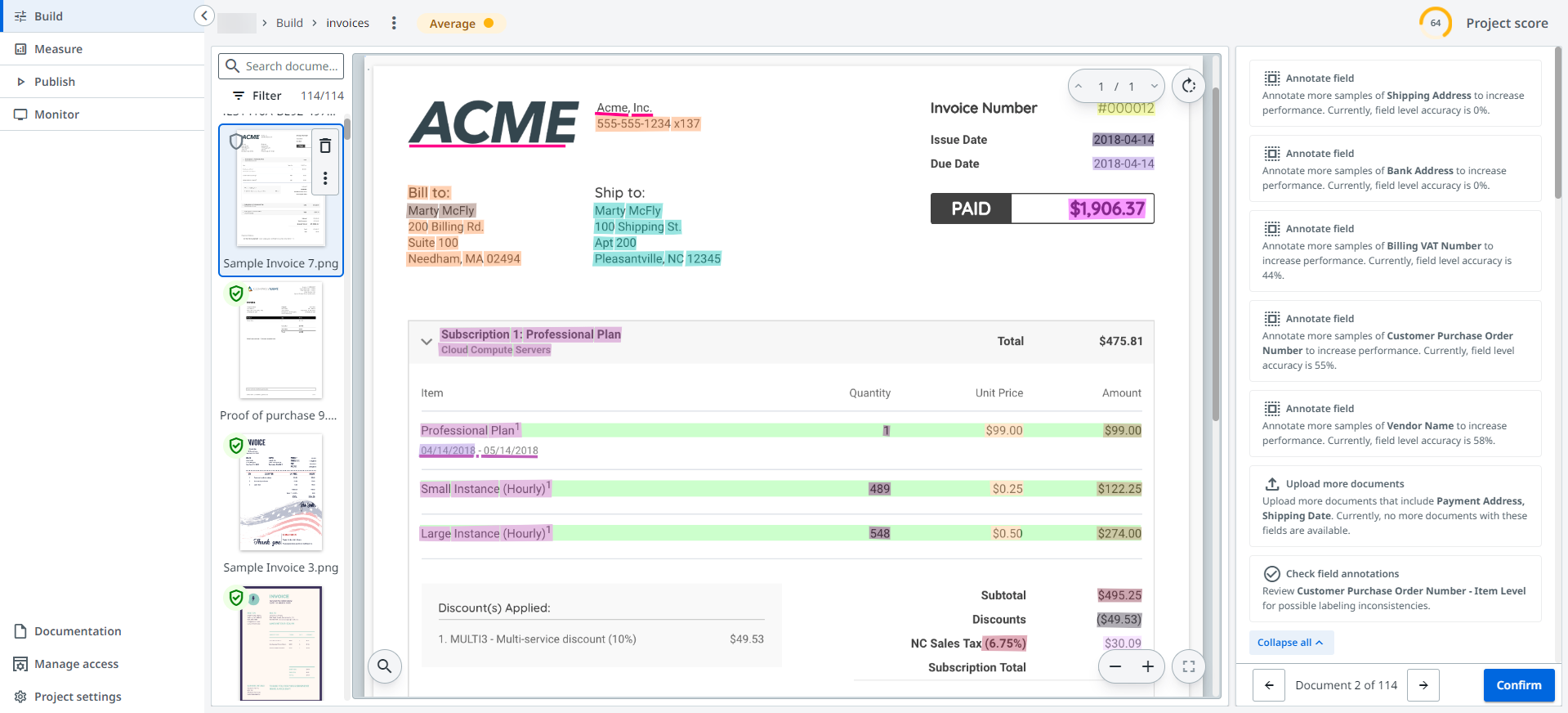

Note: To trigger model training, a minimum of 40 operations is needed. For example, if you have 20 documents, you would need to annotate at least 2 fields per document, resulting in a total of 40 operations.
Tip: To optimize model perfomance, follow the suggestions from the Recommendations section. These suggestions are designed to improve the overall performance of your model.

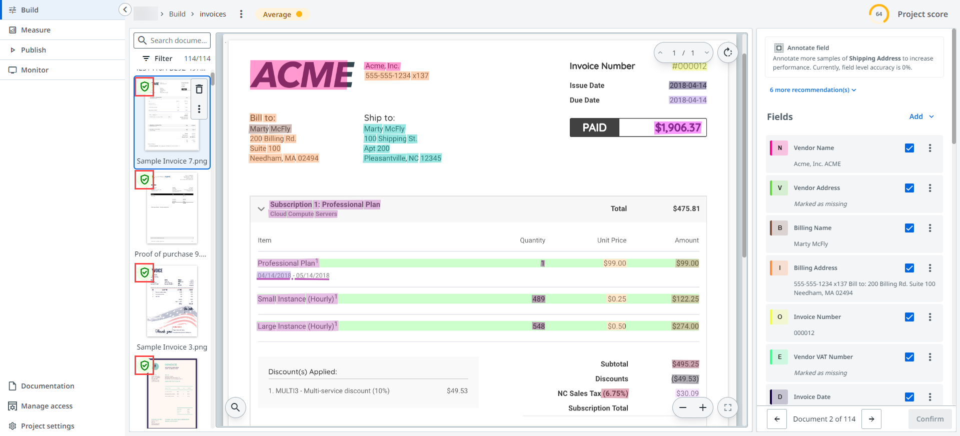

After all documents are uploaded and predicted, your goal is to either validate or modify the pre-annotated fields. For a document where all fields are accurately predicted, select Confirm to approve all fields at once. A document, once confirmed, will be signified with a green shield symbol in the document list.
If a document is only partially confirmed, it will be marked with an empty shield symbol in the document list. This symbolizes that the annotation process for this particular document is In Progress. Your end aim should be to make sure that all documents are Confirmed.

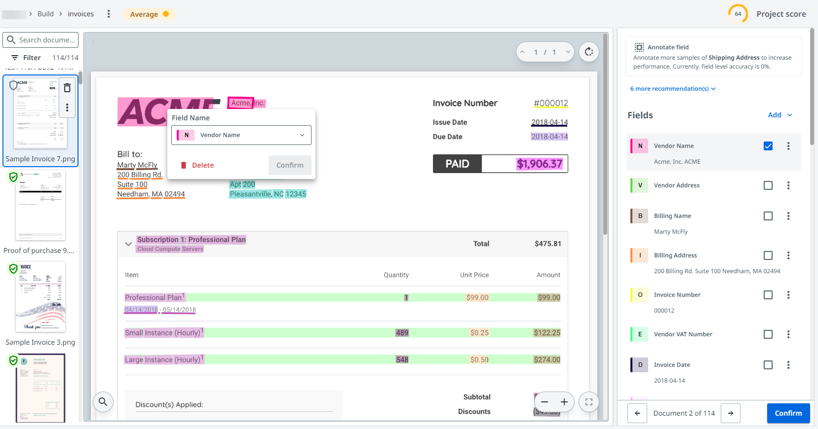

Prediction is incorrect and the field is present on the document
If the prediction is incorrect, select the correct text from the document and the appropriate field from the dropdown, then select Confirm.

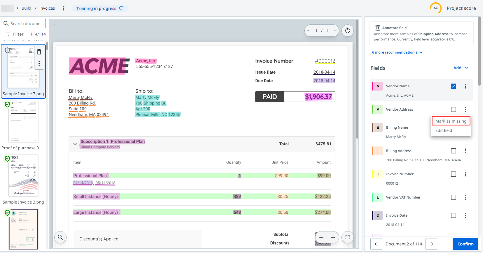

If there prediction is incorrect and the field is missing from the document, select the three-dot icon next to the field name and select Mark as missing.
Important: You can also mark wrong fields as missing. For example, if you do not have a Vendor Address in your document but during processing a different field was pre-labeled as Vendor Address, you can just mark it as missing during validation.

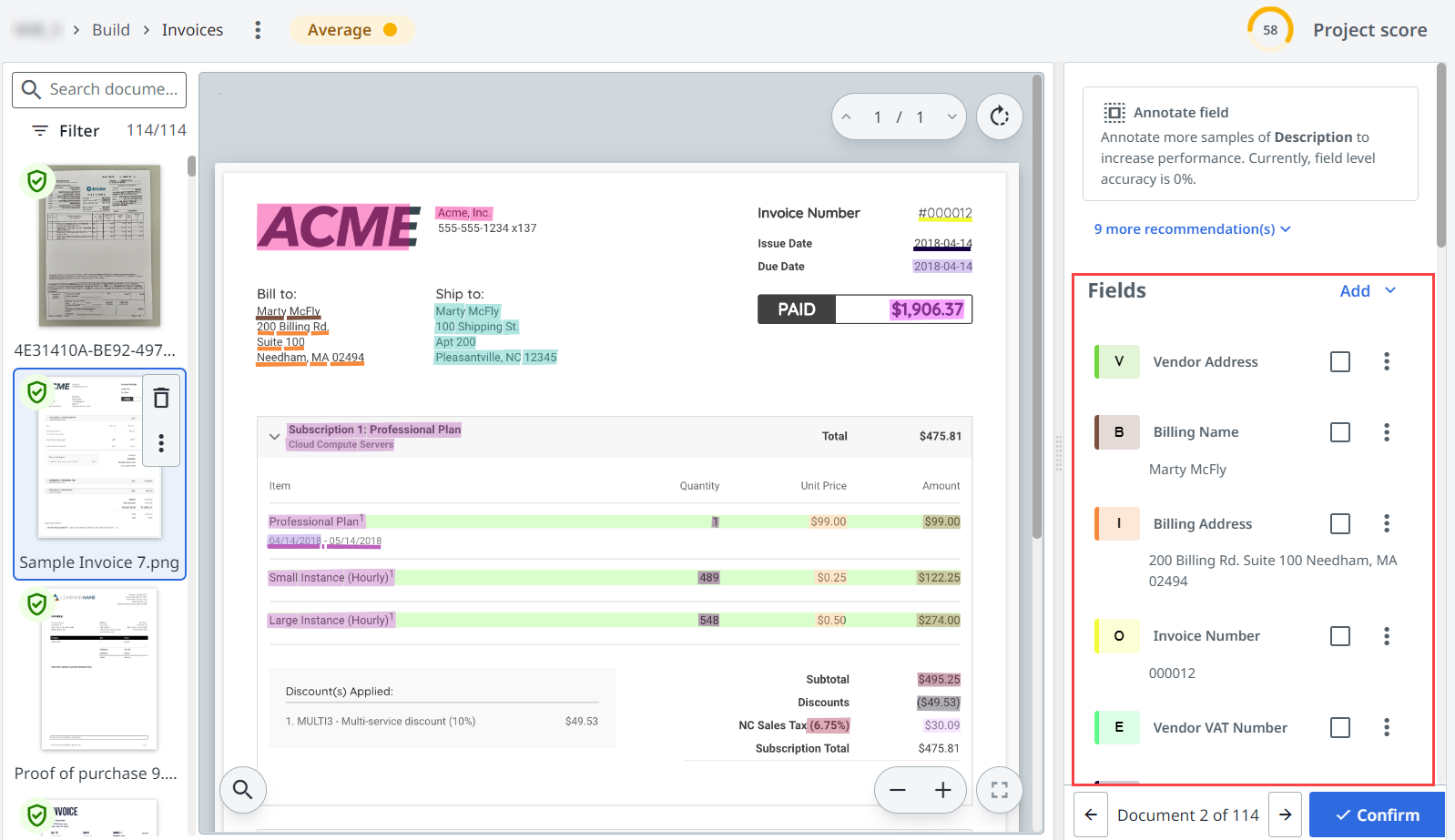

No prediction
Fields that have no prediction are displayed as empty cells. You can mark these cells as missing one by one, or in bulk by selecting the Confirm button.

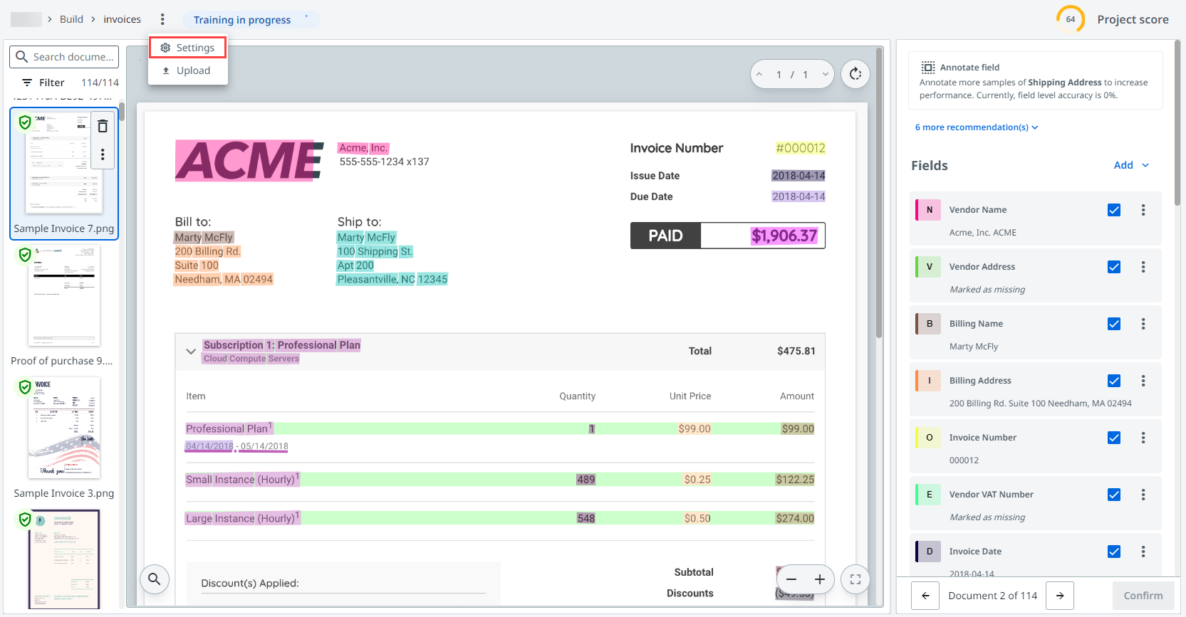

You can change the document type settings from the Annotate view.
To do so, select the three-dot icon on the right side of the document type name and select Settings.
You can change the following settings:
  • Base model: Dataset size estimations used in the Recommended Actions depend on the base model used to train. Using the most similar base model to your Document Type will reduce the amount of annotation work required.
  • Number of languages: Dataset size estimation used in the Recommended Actions depend on the number of languages in the dataset. More languages generally require annotating more data.
