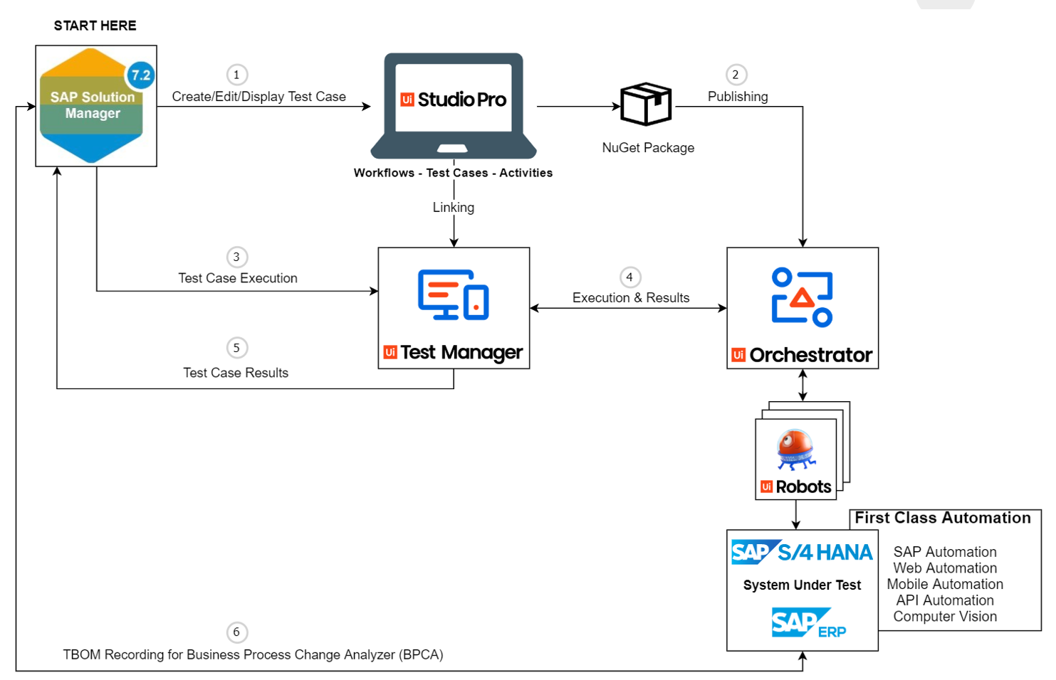

Process Flow Chart
The following flow chart represents the UiPath integration with SAP Solution Manager.
The process flow chart contains the following components:
- Test Manager Hub: Acts as a connection hub between all UiPath and SAP components.
- Test Manager: Ensures test execution, log collector, and test data transfer SAP Solution Manager.
- Orchestrator: Manages test case execution.
- Robot: Performs test executions. The Robot is connected to SAP WinGUI and automates SUT (e.g. SAP S/4 HANA)
The flow is done through the following steps:
- Creation of a test case from SAP Solution Manager to UiPath Studio.
- Test case publishing to Orchestrator.
- Test case execution through Test Manager.
- Test executed managed through the Orchestrator and performed by the Robots.
- Results transferred from Orchestrator to Test Manager, and then SAP Solution Manager.
- Business Process Change Analyzer with TBOM Recording for automation projects.
