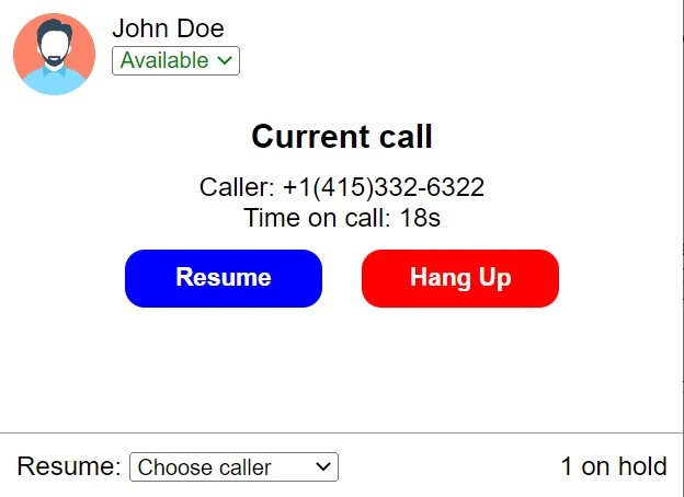

Sample app

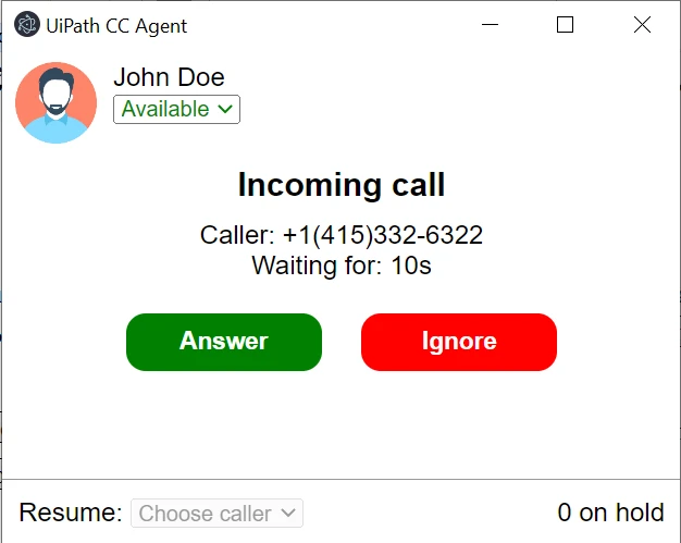

If you want to try out this tutorial with the same contact center agent application, you can download the sample app here.exe).

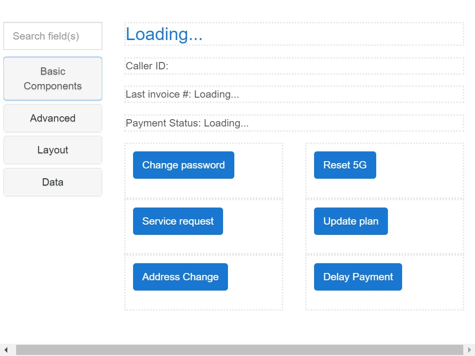

Step 2: Create customer data form
Create a form to fetch and display information about the customer that’s calling or the customer the contact center agent is talking to (Customer Data)
Create a new Form file from the Studio design ribbon. Name it Customer Data.
Add three Label/Header components that hold the name, Id, and payment status of the customer that is calling. Edit them as follows:
- First Label/Header - Type Loading… in the Contentfield and set the property name as
customerName, in the Property Name field. - Second Label/Header - Type Caller ID: in the Content field. Set the property name as
callerId, in the Property Name field. - Third Label/Header – Type Payment Status: Loading… in the Content field and set the property name as
paymentStatus.
Add six Button components, that trigger certain action events. For this example, create buttons for the following action events (using the Action dropdown):
- Change password
- Reset 5G
- Service request
- Update plan
- Address Change
- Delay payment

Add an Application Event Trigger for the incoming call app event.
- Event type – Appeared
- Scheduling mode – Sequential
Add a Use Application/Browser activity to focus on the Contact Center agent app and fetch information about the customer.

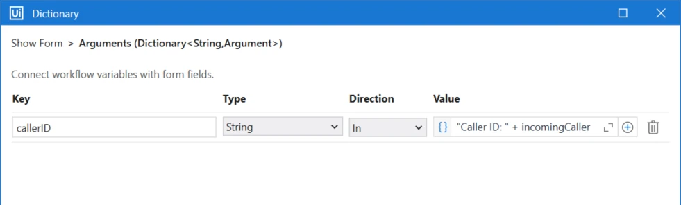

Add a Show Form activity to display the Customer Data form using the information that you previously fetched. Set the Instance Name as
incomingCaller. In the Arguments collection, pass in the customer’s phone number:

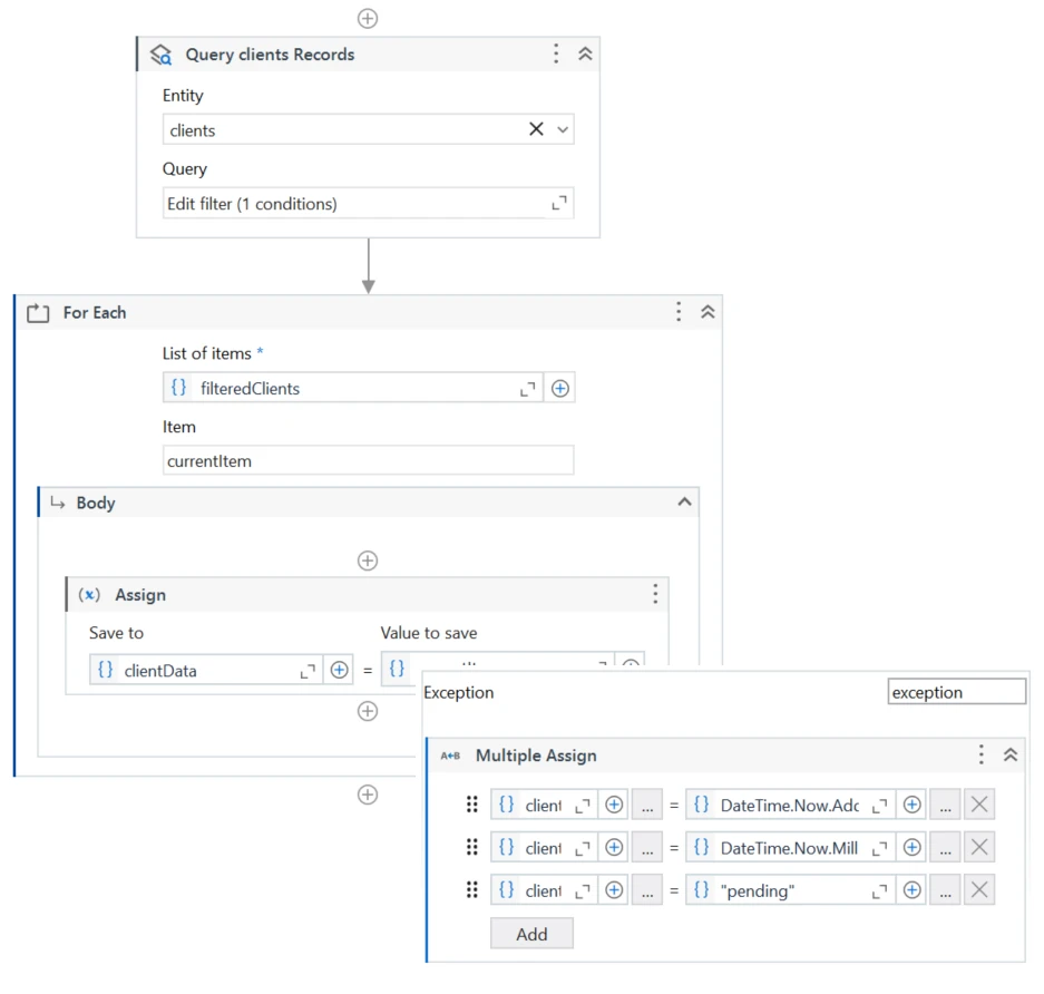

For this example, query additional client data from a Data Service entity. Save the queried data inside a local variable named
clientData. -

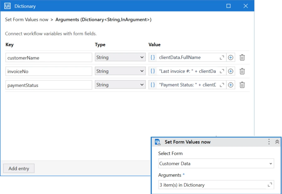

Add a Set Form Values activity, to add the previously fetched client data to the same Customer Data form instance. For this example, pass arguments for name, invoice number, and payment status.
To personalize the form instance, change its title based on the queried client data, at runtime, by adding a Change Form Properties activity.
- Select Form – Customer Data
- Title –
clientData.FullName

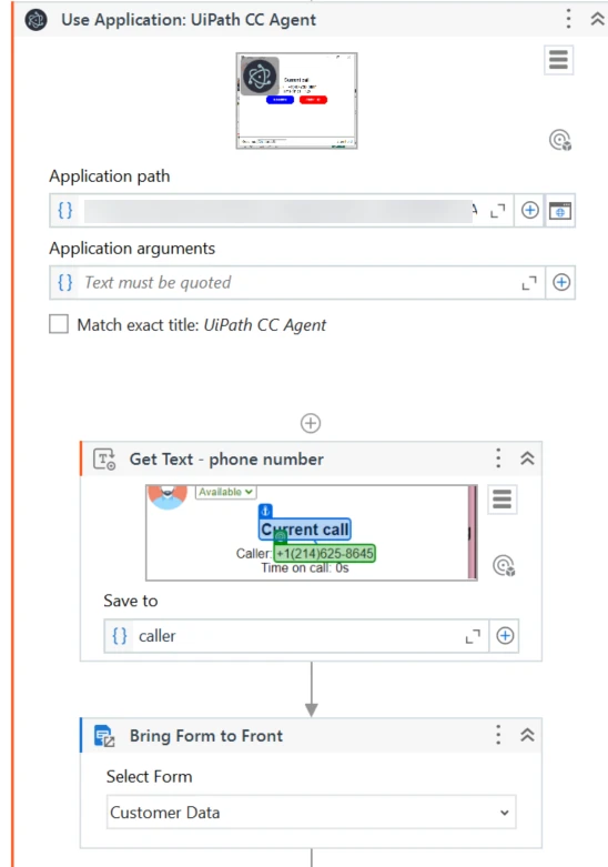

Step 4: Create workflow for current call
This workflow represents the scenario when you answer a customer call and you’re currently talking to them (on current call.xaml).
- Add an Application Event Trigger activity for the current call event.
- Scheduling mode – Concurrent
- Add a Use Application/Browser activity to focus on the Contact Center agent app and fetch information about the customer.
Add a Get Text activity and indicate the phone number. Save it to a global variable named
caller. -
Add the customer that is currently on call to the
callersglobal variable, where the Data table from the Main workflow is stored. -
Add a Bring Form to Foreground activity to bring the Customer Data form to the front, so you can focus on the customer that you’re talking to. Add a global variable named
calleras the Instance Name of the form.

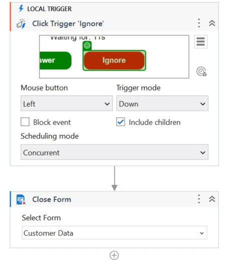

Step 5: Create workflow to ignore customer call
This workflow represents the scenario when the contact center agent clicks Ignore on an incoming call from a customer (on ignore call).
Add a Click Trigger activity for the Ignore button.
- Mouse button – Left
- Trigger mode – Down
Add a Close Form activity, to close the customer form assigned to the customer, whose call you ignored.

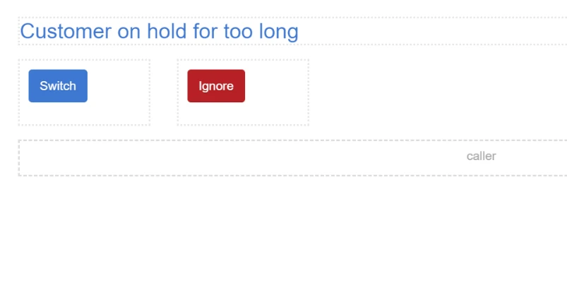

Step 7: Create form when customer is on hold for too long
This workflow represents the scenario where the contact center agent keeps a customer on hold for too long (Too long on hold.uiform).
Create a new Form file from the Studio design ribbon. Name itToo long to hold.
The Form Builder opens in the Designer panel.
Add a Label/Header component to display a message for when a customer stays on hold for too long. Set the Property Name to
message. -
Add two Button components to allow the contact center agent to switch to the customer that was held too much on hold, or ignore the customer call.
- First Button – set the Label as Switch, and the Action to event.
- Second Button – set the Label as Ignore, and the Action to event.
Add a Hidden component, and set the Property Name to
caller. That’s where we’ll show the phone number of the customer that stayed on hold for too long.

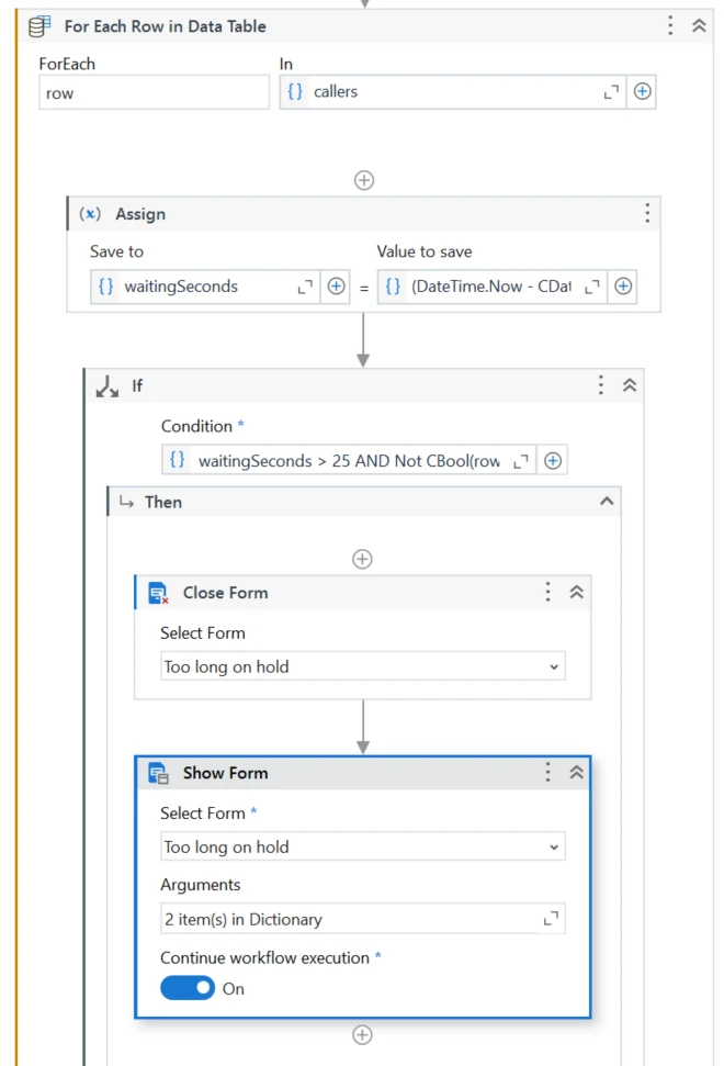

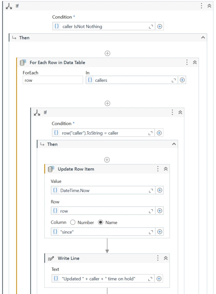

Step 8: Create workflow to check Hold time
This workflow tracks the time a customer stays on hold.
- Add a Repeat Trigger activity to constantly check the time customers are on hold. For this example, set the Interval to 5 seconds.
- Search for the time a customer was on hold in the
callerglobal variable, that you usedto store data about the customer. For this example, if a customer was on hold for more than 25 seconds, then the Too long on hold form appears.

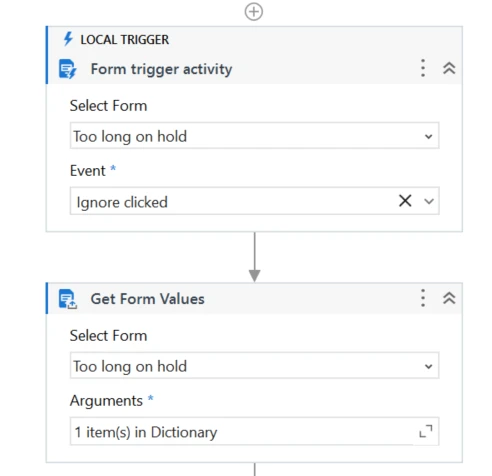

This workflow represents the scenario where the contact center agent clicks Ignore in the Too long to hold form.
Add a Form Event Trigger activity, to trigger other activities when the Ignore button is clicked.
- Select Form – Too long to hold.
- Event – Ignore clicked.

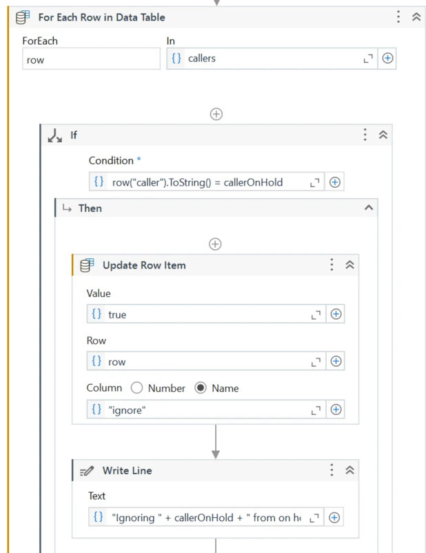

Add a Get Form Values activity, to fetch the phone number of the customer that stayed too long on hold.
Add the phone number of the customer that you fetched at step 2, in the
callersdata table. -
Add a Close Form activity to close the Too long on hold form after the Ignore button is clicked.

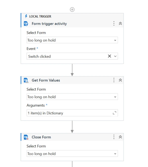

Step 10: Create workflow for switching to call on hold
This workflow represents the scenario when the contact center agent clicks Switch in the Too long to hold form.
Add a Form Event Trigger activity, to trigger other activities when the Switch button is clicked.
- Select Form – Too long on hold
- Event – Switch clicked
Add a Close Form activity, to close the Too long on hold form.

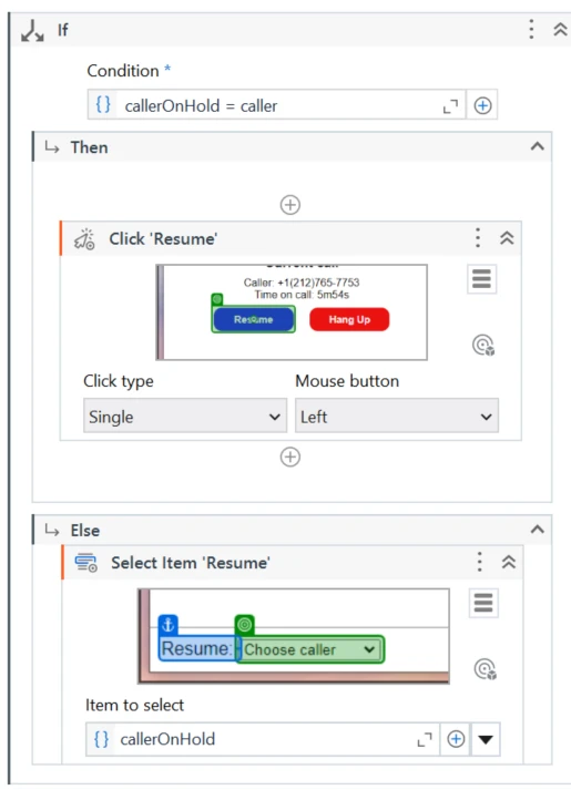

Add a Use Application/Browser activity to focus on the contact center agent app and resume the call with the customer from the Too long on hold form.
Add an If activity that:
- Clicks Resume in the contact center agent app if the customer on hold is available in the contact center agent app, using a Click activity.
- Selects the phone number of the customer you want to switch to, using a Select Item activity.
