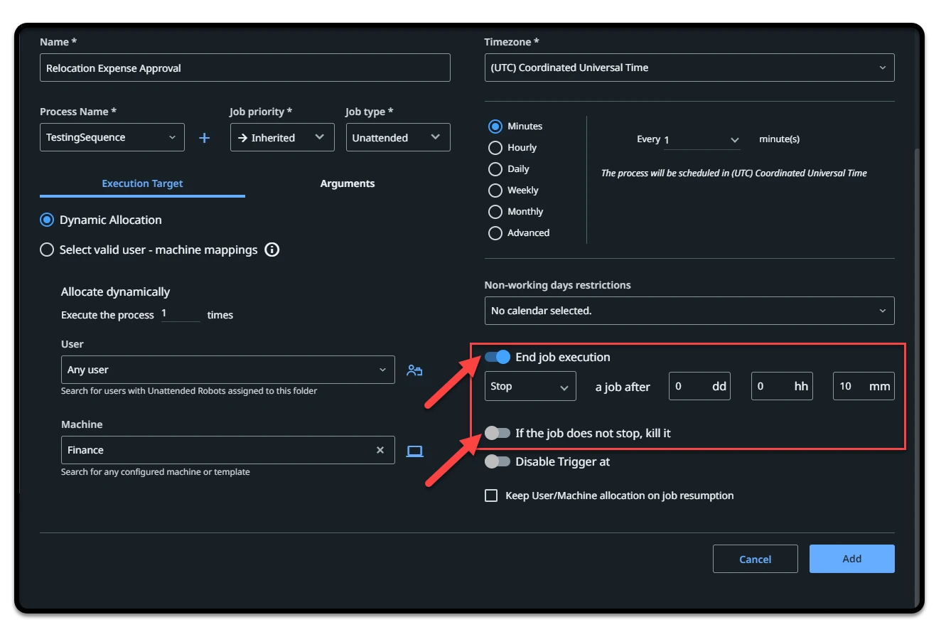

  12. Enable the End job execution option to select a job termination strategy.
    Note:
    The amount of time specified here elapses according to the specifications, even if the job is queued. For example, if you schedule a job to run at 1 p.m. and set it to stop after 20 minutes, the job stops at 1:20 p.m. even if it had stayed in a queue until 1:15 p.m., and then started.
    Additionally, if you schedule to stop a Pending or Running job after 2 hours and also configure to kill the same job after 3 hours, the job will be killed after 5 hours. This happens because, first, the signal is sent to Orchestrator that the job was indeed stopped after 2 hours. Once the signal has been received, the kill job action is triggered to occur in 3 hours, thus resulting a total of 5 hours.
    • Select Stop from the drop-down - attempts to gracefully end the execution after the defined time interval has passed since the job is stuck in a Pending or Running state (set the time to a minimum of 1 minute, maximum of 10 days, 23 hours and 59 minutes);
      Example: Orchestrator will attempt to stop jobs that have been stuck for at least 10 minutes in Pending or Running.
    • Select Kill from the drop-down - attempts to forcefully end the execution after the defined time interval has passed since the job is stuck in a Pending or Running state (set the time to a minimum of 1 minute, maximum of 10 days, 23 hours and 59 minutes);
      Example: Orchestrator will attempt to kill jobs that have been stuck for at least 10 minutes in Pending or Running.
    • Select Stop from the drop-down and enable the If the job does not stop, kill it option - attempts to gracefully end the execution after the defined time interval has passed since the job is stuck in a Pending or Running state and then attempts to forcefully end it after the defined time interval has passed since the job is stuck in a Stopping state (set the time to a minimum of 1 minute, maximum of 10 days, 23 hours and 59 minutes).
      Example: Orchestrator will attempt to stop jobs that have been stuck in Pending or Running for at least 10 minutes. If the termination does not happen, Orchestrator will attempt killing those jobs that have been Stopping for at least 20 minutes.
  13. Enable the Disable Trigger at toggle, and enter the date and time when the trigger is to be disabled. The selected time zone selected when the time trigger gets disabled.

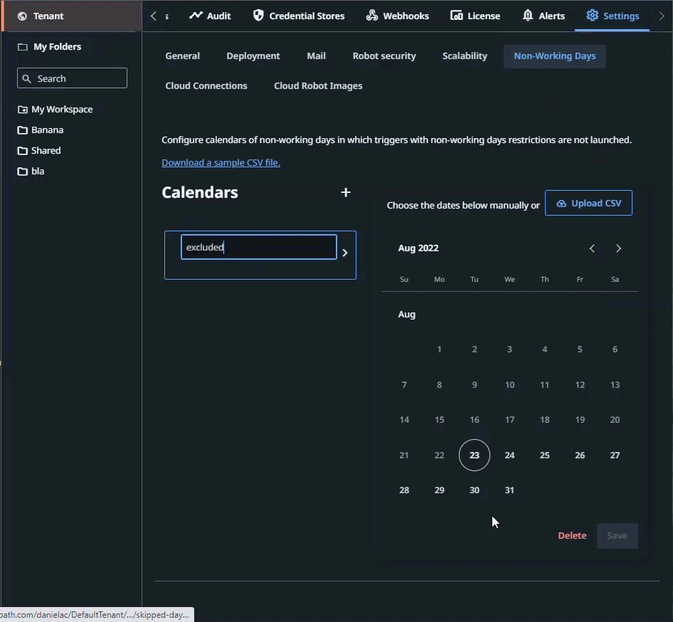

Managing Non-Working Days​
Creating New Calendars​
  1. Open the Non-Working Days tab on the Settings page. A list with all the calendars previously defined is displayed, ordered alphabetically.
    The BankHoliday calendar is displayed here, if it exists. This calendar is created when upgrading your Orchestrator to 19.10 if you had non-working days defined in your previous version.
  2. Click Add to create a new calendar and type its name in the blank, highlighted field. The name must be unique, and it may contain a maximum of 150 alphanumeric characters. You can't create calendars with no names or containing only space characters.
  3. Click Save or press Enter on your keyboard to save the new calendar. The calendar is saved and displayed in the list of calendars.
  4. For the selected calendar, define non-working days either manually, or by uploading a .csv file, or a combination of these.
  5. In the Triggers page, when creating a new trigger or editing an existing one, select the desired calendar from the Non-working days restriction drop-down.
    Note:
    When you use non-working days, the trigger time zone must be the same as the tenant time zone (Tenant> Settings> General), because calendar restrictions cannot be applied in different time zones. A tenant without an explicitly defined time zone inherits it from the host.
  6. Click Update for the changes to take effect. Every change made to a calendar subsequently propagates to all triggers associated with that calendar.
By Manually Selecting Non-working Days​
  1. Click a calendar to select it. The calendar on the right-side of the window is updated accordingly.
  2. On the displayed calendar click the dates on which you want your triggers to stop firing. Click again on a selected date to deselect it.
  3. Click Save to save the selected dates as non-working days.
By Uploading .csv Files​
Enables you to upload a series of dates into a selected calendar, directly from a .csv file. Please note that the file must be populated beforehand using a predefined format so that the upload operation is successful. The new dates from your uploaded file overwrite any dates already contained in the calendar.
Note:
The .csv file must contain ExcludedDate column header. All the non-working days must be within that column, written in the YYYY-MM-DD, YYYY/MM/DD or YYYY MM DD format.
See the Example section below for more information.
Option 1​
  1. On the selected calendar click Upload csv.
  2. Navigate to the desired .csv file, select it and click Open. Orchestrator parses the file to confirm it meets formatting rules (see the example section below).
  3. Click Yes in the confirmation dialog to overwrite the dates already contained in the calendar with the new dates from your uploaded file.
  4. Click Save to save the modified calendar.
Option 2​
  1. Drag & Drop the desired . file over the selected calendar's top part. Orchestrator parses the file to confirm it meets formatting rules (see the example section below).
  2. Click Yes in the confirmation dialog to overwrite the dates already contained in the calendar with the new dates from your uploaded file.
  3. Click Save to save the modified calendar.
Example​
Let's say you upload into a calendar the content of the following .csv file. An easy way to create such a file is to populate the data into an excel file and save it as a .csv file:
Or you can download a .csv file with all the pre-filled column headers and customize it to your needs.
Notice that this file contains a predefined column header, ExcludedDate. Enter all your non-working days in that column, using YYYY-MM-DD,YYYY/MM/DD or YYYY MM DD format.
Renaming Calendars​
  1. Select a calendar in the Non-Working Days tab on the Settings page.
  2. Modify the name of the calendar.
  3. Click Save to save the changed name.
Deleting Calendars​
  2. Click Delete.
  3. Click Yes in the pop-up window to confirm your intent. The calendar is deleted.
    Note:
    You can only delete calendars that are not attached to any triggers.
You can also remove non-working days from a calendar. After clicking on a non-working day it is no longer marked. Remember to save your changes.
