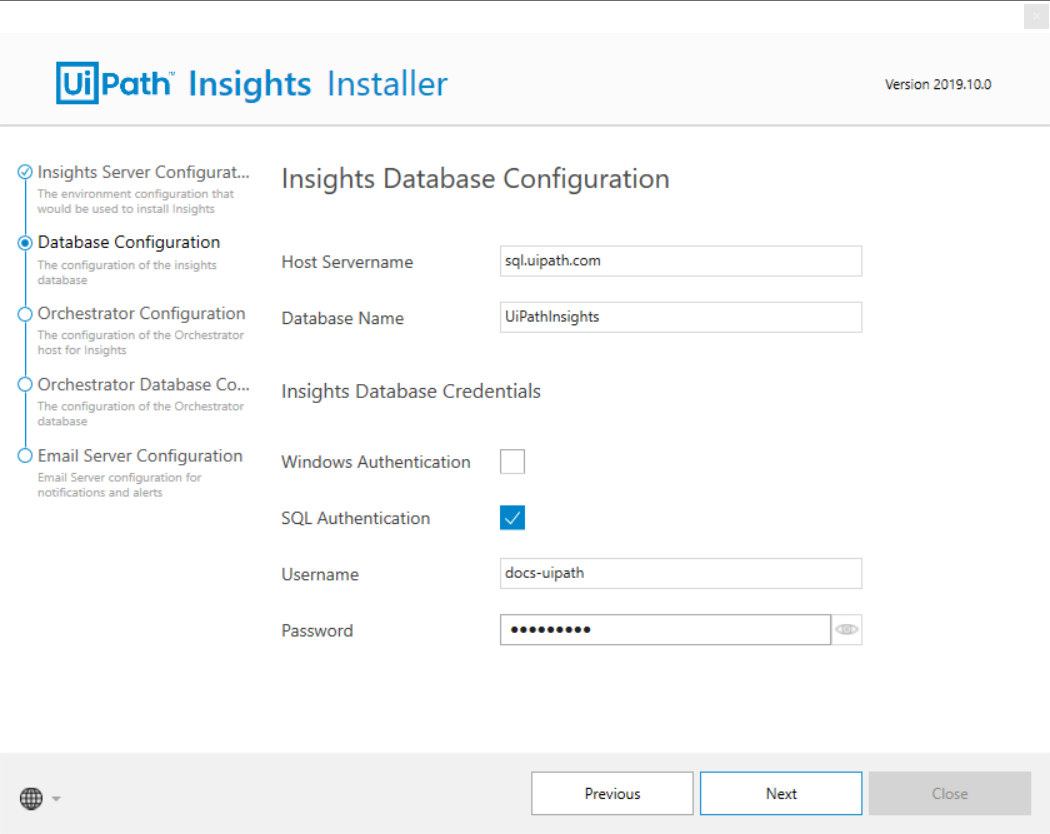

  1. Fill in the database details, as follows:
    • Host Servername - the name of the SQL Server machine where the Insights database is located. You can also specify a custom port number here using a colon, such as sql.uipath.com:1733.
    • Database Name - the name of the Insights database specified when installing Orchestrator.
    • Windows Authentication - if selected, the connection to Insights is made using a domain account. See additional configurations steps, below.
    • SQL Authentication - if selected, the connection to Insights is made using SQL authentication. If using this option, the Username and Password fields become editable and you must provide the SQL username and password used to connect to the database.
  2. Click Next. The Orchestrator Configuration is displayed.
