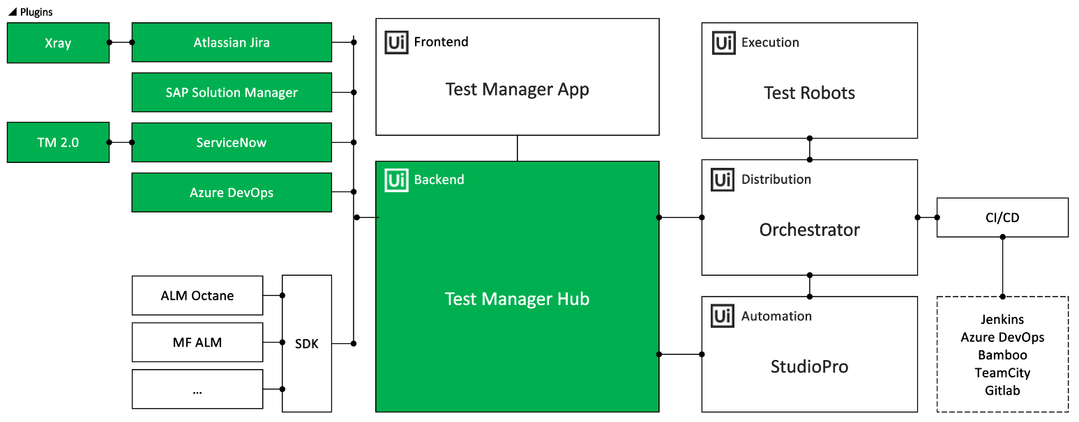

Test Manager Software Development Kit (SDK) provides Test Manager integration with your development tools. Through this type of integration, you can synchronize artefacts (requirements, stories, defects) and bring UiPath® automation capabilities.
The following architecture diagram describes the integration capabilities with UiPath® components and 3rd party tools. For more information, see Application Lifecycle Management Integration Patterns.
