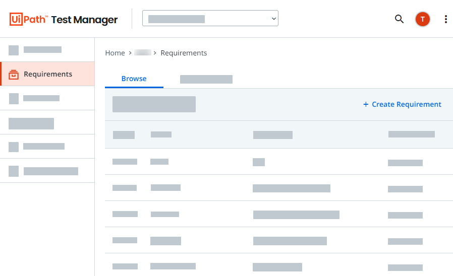

Navigation and Search
To quickly find your requirements, use the search function and the filters. Navigate within the page using and configuring the paginator. Alternatively, you can use the breadcrumb to navigate between the pages.
- Filter - You have two filter tabs to choose from:
- Browse - to list all requirements.
- Updated by me - (predefined) to list only the requirements that have been updated by the current user, running the Test Manager instance.
- Search - Use the search bar to find requirements by their key, name or labels (requires full search term match).
You can use the search bar at the top of the page to look for items across Test Manager (e.g., test sets, test cases).

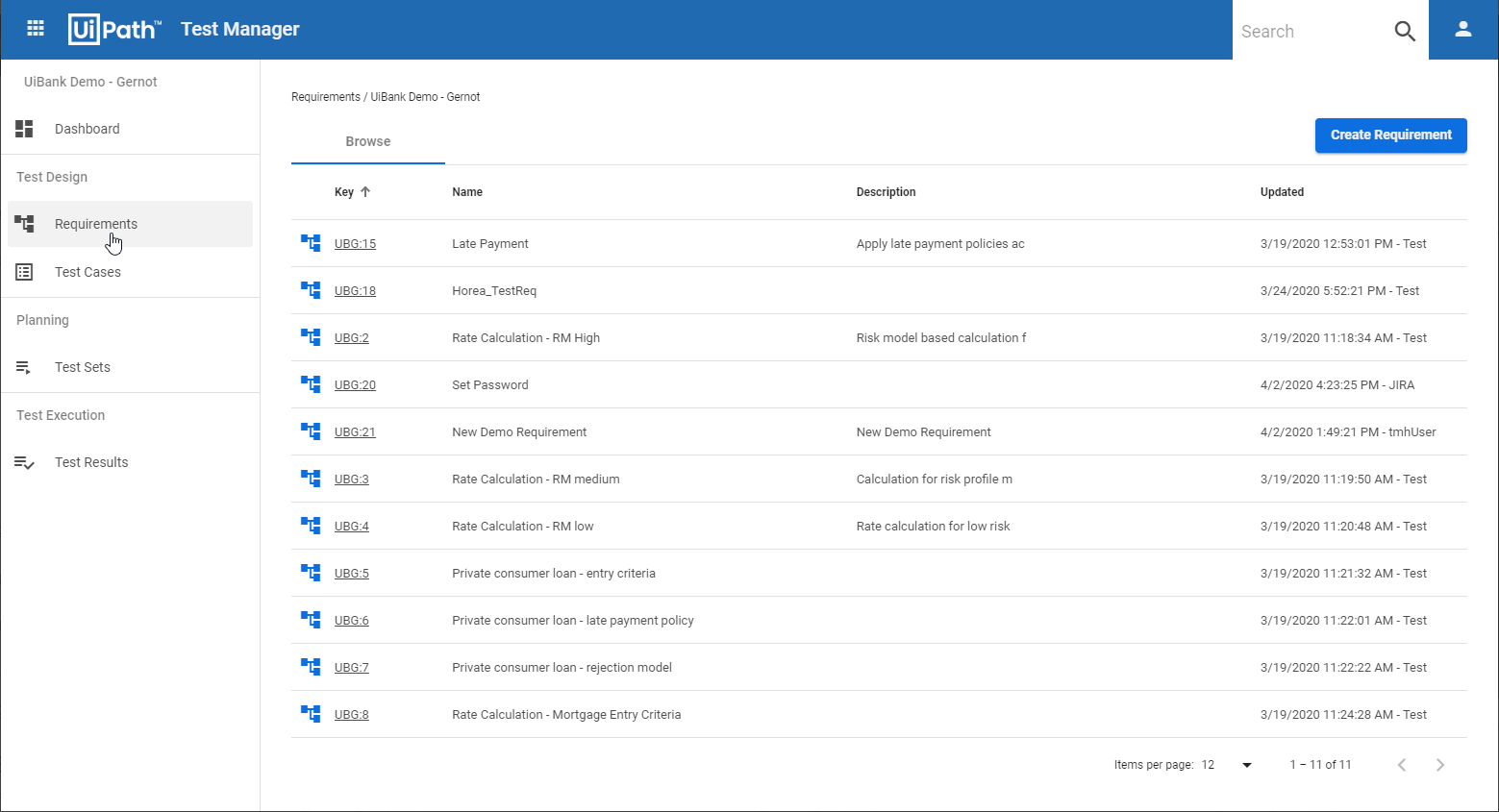

Creating Requirements
To create requirements in a Test Manager project:
- In the Test Design menu, navigate to the Requirements page.
- Click Create Requirement. The Create Requirement window is displayed.
- Fill in the fields accordingly:
- Name - The name for your requirement.
- Description - (Optional) Add any description to the requirement. In order to add formatted text, use Markdown syntax.
- Optionally, add any number object labels.
- Click Create. Your new requirement is displayed in the Requirements page.
