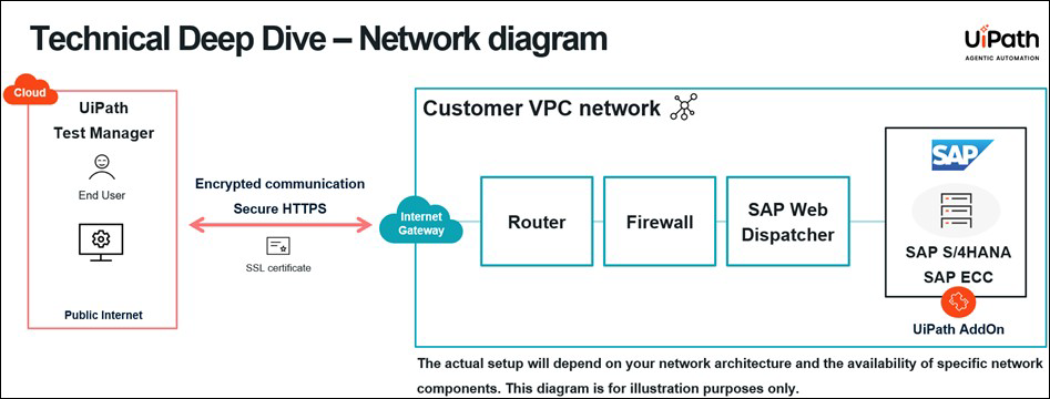

Ordered prerequisites for Heatmap and Change Impact Analysis in standalone Test Manager, with an architecture overview of the full setup workflow.
To set up the Heatmap and Change Impact Analysis, you need to follow four main configuration steps. You must perform these steps in the specified order to ensure a correct setup:
- Install the UiPath SAP Add-On.
- Configure your SAP system.
- Configure UiPath Test Manager.
For an overview of the overall setup of the Heatmap and Change Impact Analysis, refer to the following architecture diagram:
Figure 1. Heatmap and Change Impact Analysis setup architecture
