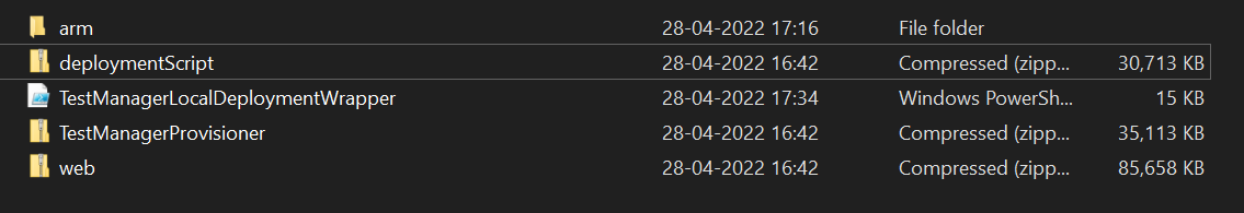

To set up the deployment environment for Test Manager, create a folder named arm and place it next to all the artifacts downloaded under Requirements. Inside the arm folder, you need two files:
- an empty
params.jsonfile mainTemplate.jsonfile
The folder location for your packages will look like in the screenshot below.
