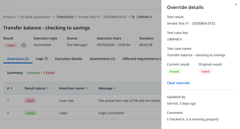

Overriding test results
Overriding the results of a test case can help in scenarios where the current test result does not accurately reflect the actual behavior of the application and re-execution is not an effective solution. You can override the test results of a test case and then you can clear the operation, if needed.
  1. Navigate to Execution and open a test result.
  2. From the Results tab open a test case log.
  3. In the Assertions tab, select Tasks > Override result.
  4. In the Override test result window configure the following fields:
    1. Change result to - select whether you want to override the result with the opposite status (Passed/Failed) or set the result to None.
    2. Comment - Type the reason why you override the result.

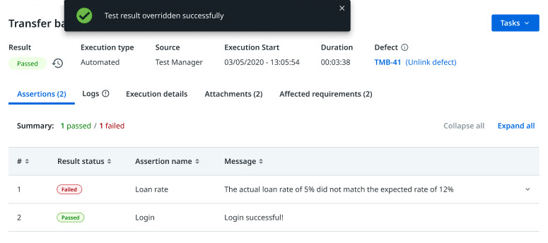

  5. Select Confirm. The test results that you overrode have the following icon next to the test result status: docs image. Select the icon and you can view the override details.
    Figure 1. The "Test result overridden successfully" message
  6. Optionally, if you want to clear the override operation, select the docs image next to the result status of a test case log.
    1. In the Override details window, select Clear override.
      Figure 2. The Override details menu
  7. Optionally, if you want to edit the override operation, select the docs image next to the result status of a test case log.
    1. Perform changes, and select Confirm.

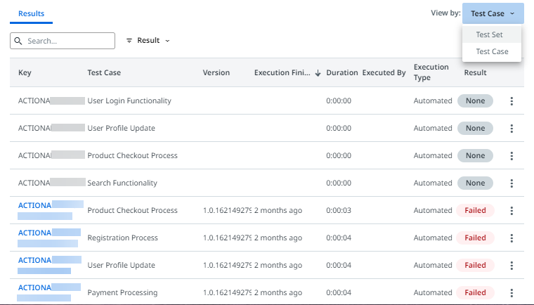

Working with test execution results
To view detailed test results, go to Execution.
In the Results tab, select View By and choose your preferred view for test results. You can select one of the following views:
  • Test Set: Test results are grouped by Test Execution (Test Set).
  • Test Case: For cross-execution analysis when filtering the results based on criteria excluding test execution attributes.

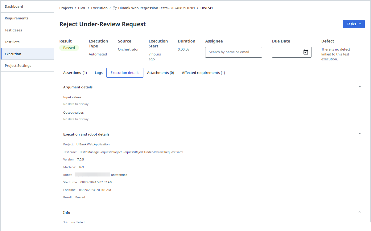

Execution log
As part of test reporting, execution logs hold information such as execution details (e.g., data variation and screenshots), failed and passed assertions, and a detailed log of execution events.
To open a test case log, go to Executions, open a test execution and then click a test case Key.
Figure 3. Overview of the execution details of a test case log
In the following table, you can view the type of information that is collected during test case execution.
Test execution reporting
Description
Assertions
View failed or passed assertions (e.g., Verify expression activity ), and associated screenshots if any were taken during test case execution. To make sure that Orchestrator takes screenshots during executions, visit the following resources:
  • Default roles in Orchestrator - to check if the default roles have the Test Case Execution Artifacts permission assigned. In case the default roles don't have this permission, then you can create a custom role with this permission.
  • Managing roles in Orchestrator - to learn how to create, edit, or import a role in Orchestrator.
Logs
View INFO level logs as part of the RobotLogs , with information about processes, execution robot, and event logs, including failures.
Select the docs image icon to go to the Logs tab of the selected test case, for a detailed description of the failure.
Execution details
View argument details such as input and output values, as well as execution and robot details (e.g., project, machine, robot).
Affected requirements
View the requirements that are assigned to the test case that has been executed. You can use this tab to go directly to the affected requirement.
Attachments View:
  • the attachments uploaded using the Attach Document activity.
  • the attachments of a test case result, that is linked from Orchestrator.

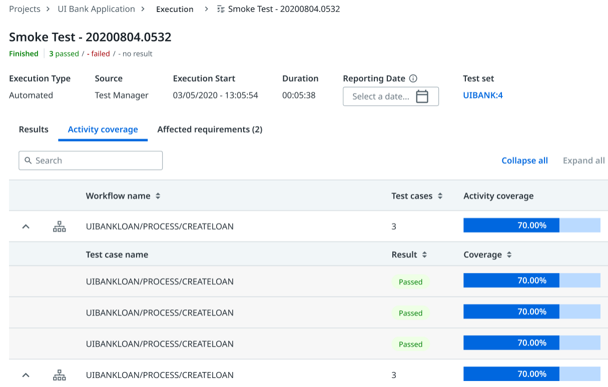

Viewing activity coverage
Note:
Activity coverage is available only for automated test executions.
Prerequisites: Enable activity coverage for the desired test sets either in Orchestrator or Test Manager.
  1. Open the test set, select More Options docs image and then Execute Automated.
  2. Go to Execution and open the test set you executed.
  3. Go to the Activity Coverage tab and investigate the information on the activities that were covered during the test execution.
    Figure 4. Overview of an example activity coverage
