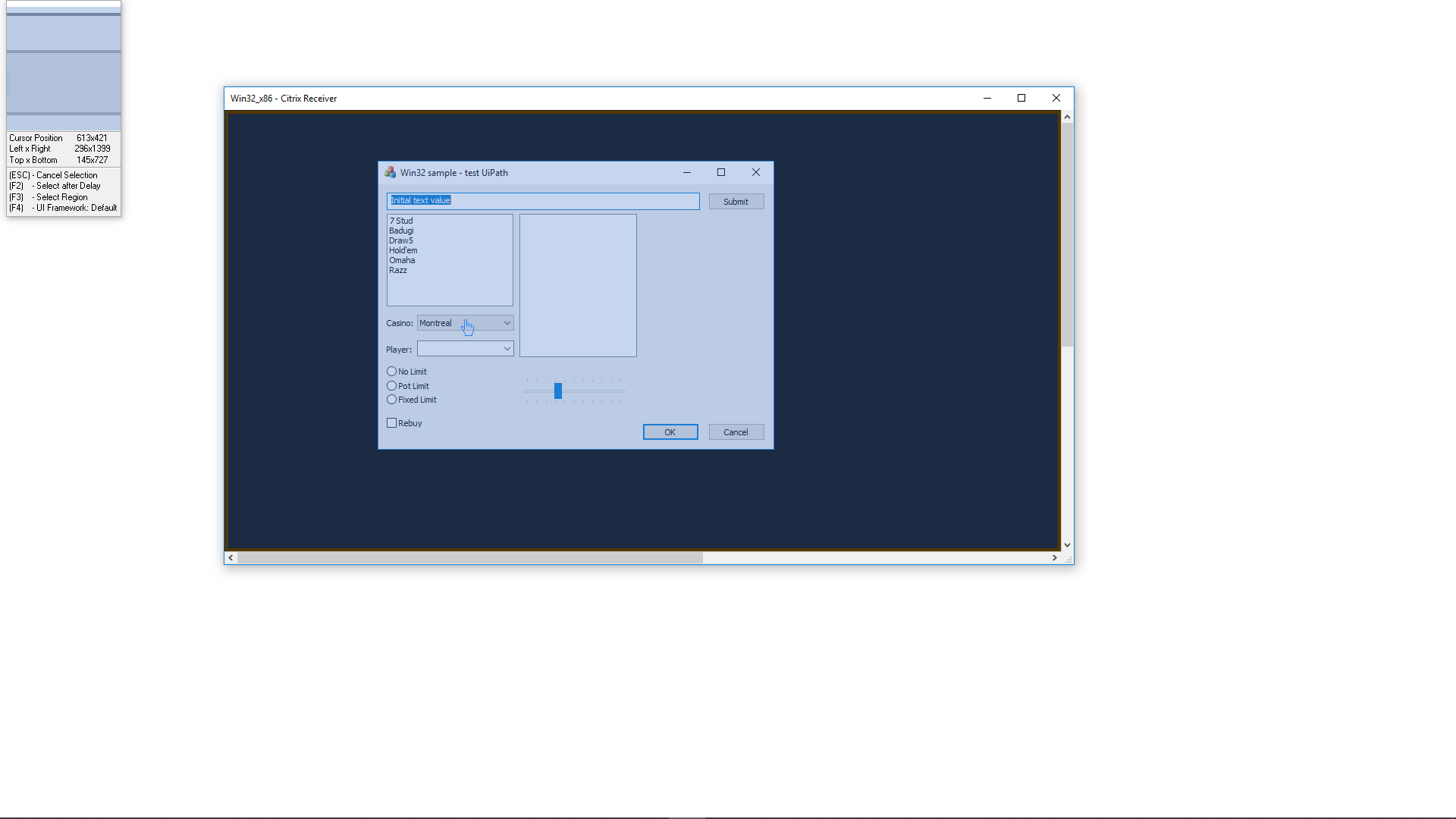

Interactive Selection in Citrix Apps is Imprecise And Appears Offset
Observed Behavior
When using interactive selection in Citrix Apps, the UI element highlight is imprecise and can appear offset.
Cause
This occurs because of the High DPI scaling performed by the Citrix Receiver.
Solution
This issue can be solved by disabling the High DPI scaling option from the Citrix Receiver, as described on this page.

Interactive Selection Does Not Detect Individual UI Elements
Observed Behavior
After installing the Citrix Extension on the client machine and the UiPath Remote Runtime component on the Citrix servers, interactive selection does not work.
Cause
This issue occurs if your Citrix Apps are running in Windowed Mode. This can be verified by toggling the Windowed Mode (bring the Citrix App into focus and press Shift + F2).
Solution
To fix this issue, you can either exit the Windowed Mode, or upgrade the UIAutomation package to version 2019.4 or newer. For more details, go to this page.
