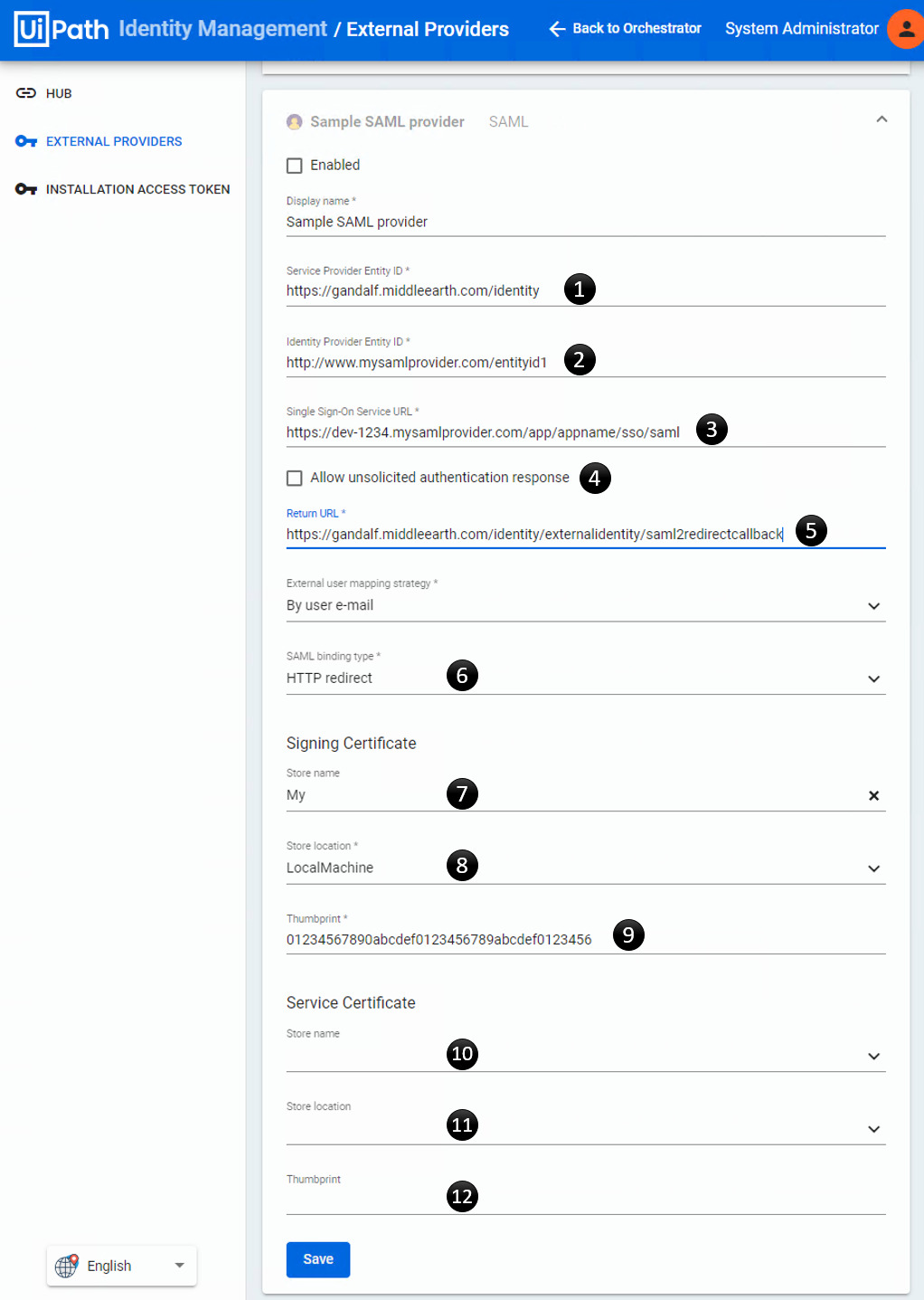

Configuring SAML Settings Unavailable in Identity Server UI
The following workaround addresses scenarios where you installed Orchestrator v2020.4 or later and need specific settings for your SAML provider to work.
Whereas the Identity Server UI should meet most of your needs in terms of SAML configuration, this section provides a way to control additional SAML settings that are not exposed by default. For a complete list of available settings, refer to the official Sustainsys.Saml2 documentation.
Sustainsys.Saml2 is the library Identity Server relies on for SAML support, and it uses an XML configuration file. To get access to the fields that are unavailable in the Identity Server UI, you need to override this XML file. The following procedure describes how you can manage that:
  1. Make sure you enabled and properly configured the SAML external identity provider on the External Providers page in Identity Management Portal.
  2. Edit the appsettings.json or appsettings.Production.json file to include the following section at the root level. This tells Identity Server to look for a file called saml2.xml in the same folder as the web application and the appsettings.json or appsettings.Production.json.
    "Authentication": {
       "Saml2": {
         "ConfigFile": "saml2.xml"
    "Authentication": {
       "Saml2": {
  3. Create an XML file called saml2.xml and add the SAML configuration.
  4. Map the fields on the External Providers page in Identity Management Portal to the corresponding nodes in saml2.xml.
Figure 1. External Providers
Screenshot of the External Providers page
<?xml version="1.0" encoding="utf-8"?>

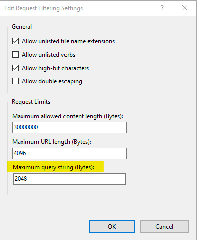

Intermittent 404 Error When Logging Out
The request to log out can sometimes have a URL query string that exceeds the default maximum query string length allowed by IIS. Here are two ways to modify this setting:
Important:
Changes to the web.config are not preserved on upgrade as of the 2021.10 release.
Using the IIS Manager Tool
  1. In the Connections tree, navigate to Sites -> UiPath Orchestrator -> Identity.
  2. Double-click the Request Filtering icon.
  3. On the right-side pane, click Edit Feature Settings.
  4. Increase the value for Maximum query string (Bytes).
Figure 2. Edit Request Filtering Settings
Screenshot of the Edit Request Filtering Settings page
Note:
You may also want to increase the Maximum URL length (Bytes) since the query string is part of the overall URL length.

To address this issue, you can adjust the query string length limit in IIS.
Figure 3. Edit Request Filtering Settings
Note:
