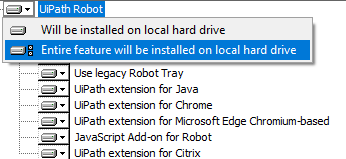

UiPathStudio.msi
The UiPathStudio.msi file allows you to install the Robot and Studio. Administrator rights are required for installation. Command Line Arguments can be used with this file.
This file installs the Robot in the C:\Program Files (x86)\UiPath\Studio directory. It can only be changed with command line arguments.
Clicking the Advanced button in the installer opens the Product Features window, which allows you to choose the components you want to install.
By default, Studio and Robot are installed. This is recommended if you want to both design and execute automation projects on that machine.
If you only want to install the Robot, click the buttonbutton button next to the UiPath Studio feature and select the Entire feature will be unavailable option.
The Service Mode Robot is installed by default. This is recommended for unattended automation scenarios and large-scale platform deployments, and runs with the same rights as the user under which it is registered.
If you want to install the User Mode Robot, click the buttonbutton button next to the Register as Windows Service feature and select the Entire feature will be unavailable option.
To install an additional feature, click the buttonbutton button next to it and select the Will be installed on the local hard drive option.
The following additional features can be installed:
  • Install local activities feed - Creates the local activities feed, in the C:\Program Files (x86)\UiPath\Studio\Packages folder, by default. This option is enabled by default. Having the activities packages locally is useful if you do not intend to connect your Robot to Orchestrator, or you want to have better control of the activities used in an automation project. Check out the list of default activities packages here.
  • Automatically start client - Starts the Robot tray at Windows startup. This option is disabled by default.
  • Use legacy Robot Tray - If selected, deploys the Robot Tray (legacy) instead of UiPath Assistant.
  • UiPath extension for Java - Installs the UiPath extension for Java for a better integration and automation in regards to Java applications. This option is disabled by default. Please note that installing the Java Bridge may cause the installation to last longer than usual. This option installs the Java Bridge only in the system drive Java folders. If you are using custom JRE not located on the system drive, you have to manually install it with the ScreenScrapeJavaSupport Tool.
  • UiPath extension for Chrome - Installs the UiPath extension for Chrome needed for automating processes in Chrome. This option is disabled by default.
  • UiPath extension for Microsoft Edge Chromium-based - Installs the UiPath extension for the New Edge Browser.
  • JavaScript Robot Add-on - Installs the UiPath JavaScript Robot Add-on.
  • UiPath extension for Citrix - Installs the UiPath extension for Citrix.
If you want to install the Robot and all its sub-features, click the buttonbutton button next to the UiPath Robot feature and select the Entire feature will be installed on the local hard drive option.
