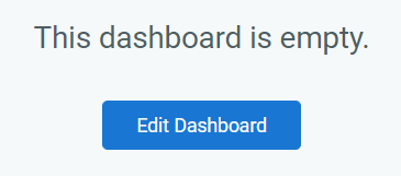

  3. In the pop-up window, enter a name for the dashboard and click the Create button. You will be directed to a blank dashboard page with the following message and button:
    Note: You cannot create or edit a dashboard if you have Insights opened in two different browser tabs at the same time.
  4. Click Edit Dashboard and then select Add Tile. You can now see a window asking you to choose an Explore. This means that you need to specify which of the entities you would like fields from (Jobs, queues, or robot logs). If you have ROI Editor permissions, you will also see the Process and Queue Manual Values Explores.

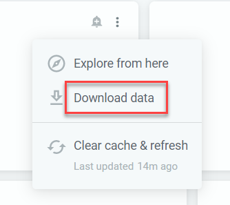

  1. Click the 3-dot menu next to any individual tile and select Download Data. A new window opens, allowing you to customize your download.
  2. In the resulting window, choose the desired file format. The following options are available:

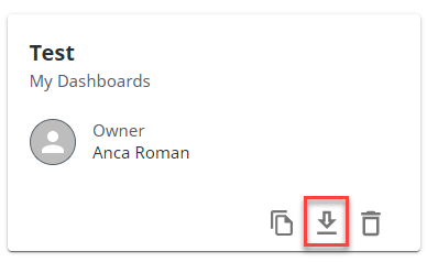

To export a dashboard, you need to click the Download icon on any dashboard card and select Export from the drop-down list.
The exported file is downloaded to the download location configured in your browser.
