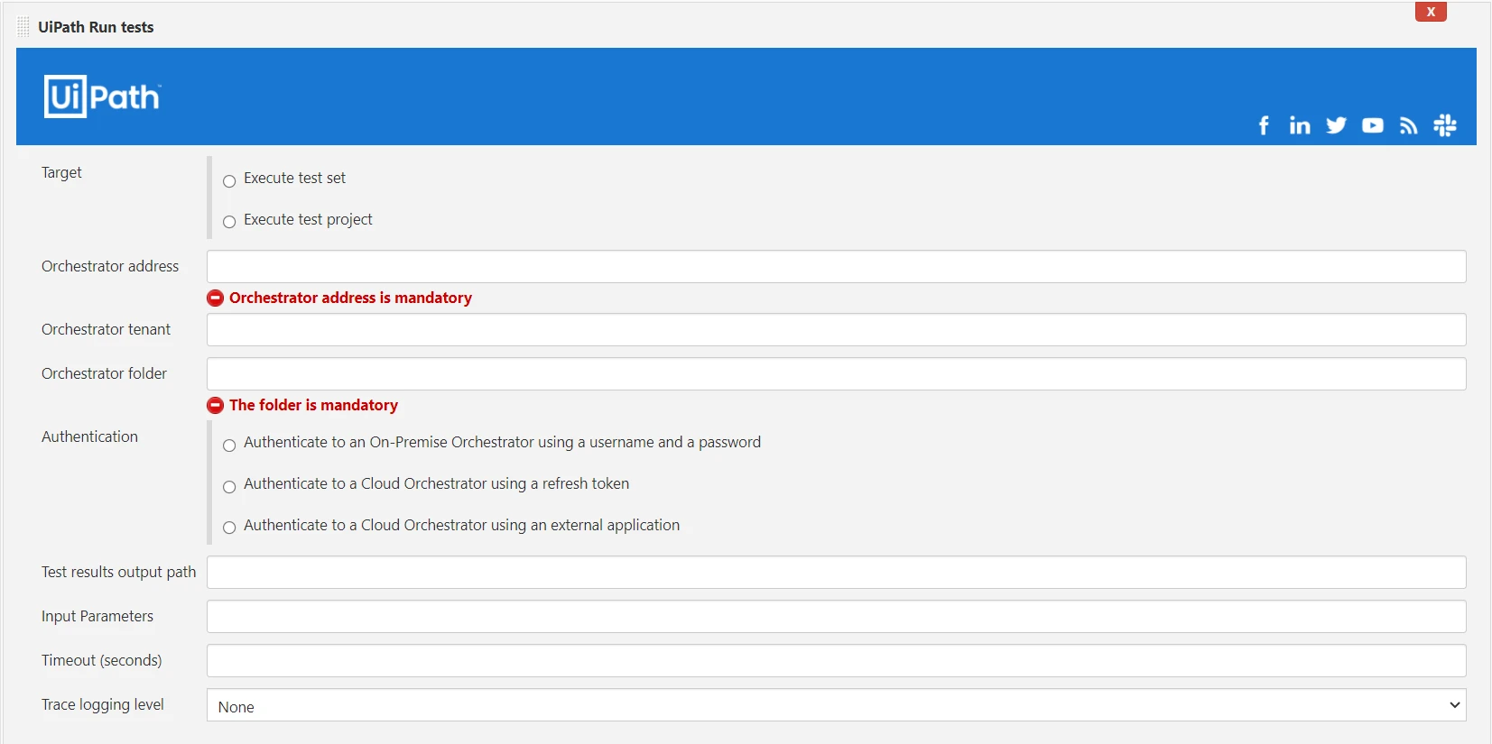

Configuration​
Job parameter Description
Target
  • Specify an existing test set on UiPath Orchestrator (to execute test set).
  • Provide the project.json path of a UiPath Testing project (to execute test project).
Test result output path
The executed test set returns the test result as junit.xml. Specify the path where the result should be stored, relative to the Jenkins workspace directory (for example, result.xml).
Input Parameters
Define custom arguments for your test cases to override default values at the test set level. Through the arguments, you can set parameters to test cases at runtime. To define arguments, you need to publish a package with arguments.
Orchestrator address
The address of the Orchestrator instance onto which the package(s) will be deployed.
Orchestrator tenant
The Orchestrator tenant onto which the package(s) will be deployed.
Orchestrator folder
The folder to deploy to.
If the folder is a Classic folder, you will also need to set the environments field.
For Modern folders, setting the environments. is not required.
To input subfolders make sure to input both the parent folder name and the name of the subfolder. For instance, use AccountingTeam\TeamJohn.
Environments (Required for Classic folders)
The environment onto which the package will be deployed as a process. For the project and environment with existing processes, the processes will be updated to use the latest project version. Specify the environment onto which the package will be deployed as a process. For the project and environment with existing processes, the processes will be updated to use the latest project version.
Authentication
For authentication towards Orchestrator, you need to create credentials in Jenkins upfront. There are four options to authenticate:
(1) Authenticate to an on-premise Orchestrator using username and password.
(2) Authenticate to a cloud Orchestrator using a refresh token (API key).
(3) Authenticate to a cloud Orchestrator using external app authentication.
(4) Authenticate to an on-premise Orchestrator using .
Timeout (seconds)
The execution timeout for the test run. The default value is 7200 seconds. If the timeout exceeds before the execution on Orchestrator is finished and returns the result, the built will cancel and be marked as failed.
Trace logging level
Setting used to enable trace logging to one of the following levels:
  • None
  • Critical
  • Error
  • Warning
  • Information
  • Verbose. (The default is set to None).
    Useful for debugging purposes.
