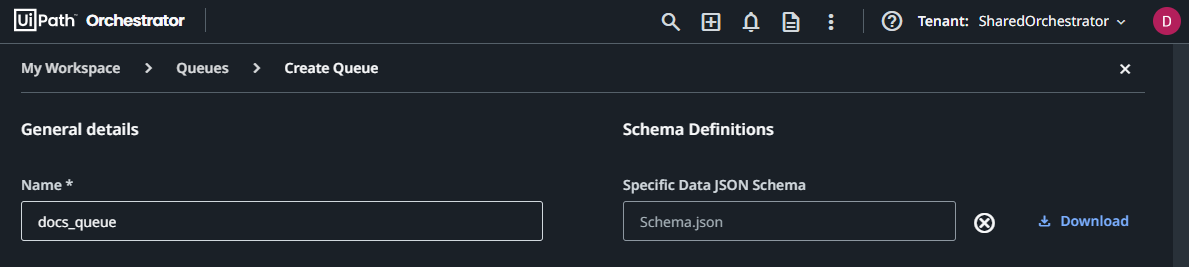

Apps can reference only the queues that were created using a Specific Data JSON Schema file.
An example of a schema definition:

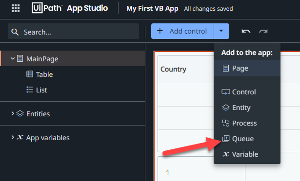

From an existing app in App Studio, expand the dropdown menu at the right of the Add control button.
Select Queue.

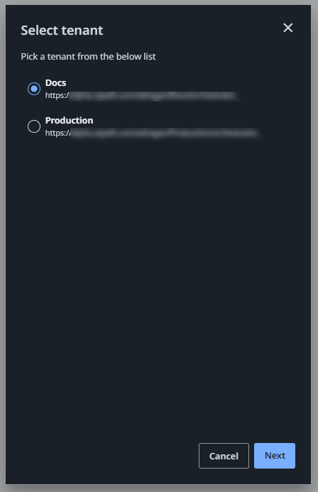

A list of tenants for the current account is displayed. Select the tenant that hosts the entities you need to import, then click Next.

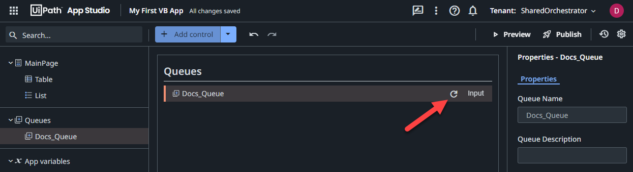

Updating a Referenced Queue
To update a referenced queue whose schema was changed, follow these steps:
From the Queues section in the tree view, select the queue you want to update.
Click on the Refresh icon.
