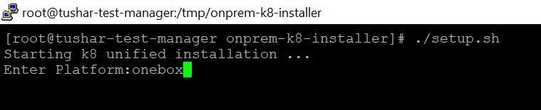

You can then run AI Fabric installer by running:
./setup.sh

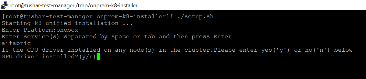

The first step is to accept license agreement by pressing Y. The script will then ask you what type of platform you want to install, enter onebox and press enter as on image below:
You will then be asked if a GPU is available for your setup and Y or N depending of your hardware. Make sure that drivers are already installed.
Using GPU
Only NVIDIA GPU's are supported and drivers need to be installed prior AI Fabric installation.
Depending of your system you might be asked to press Y few times for the installation to complete.
