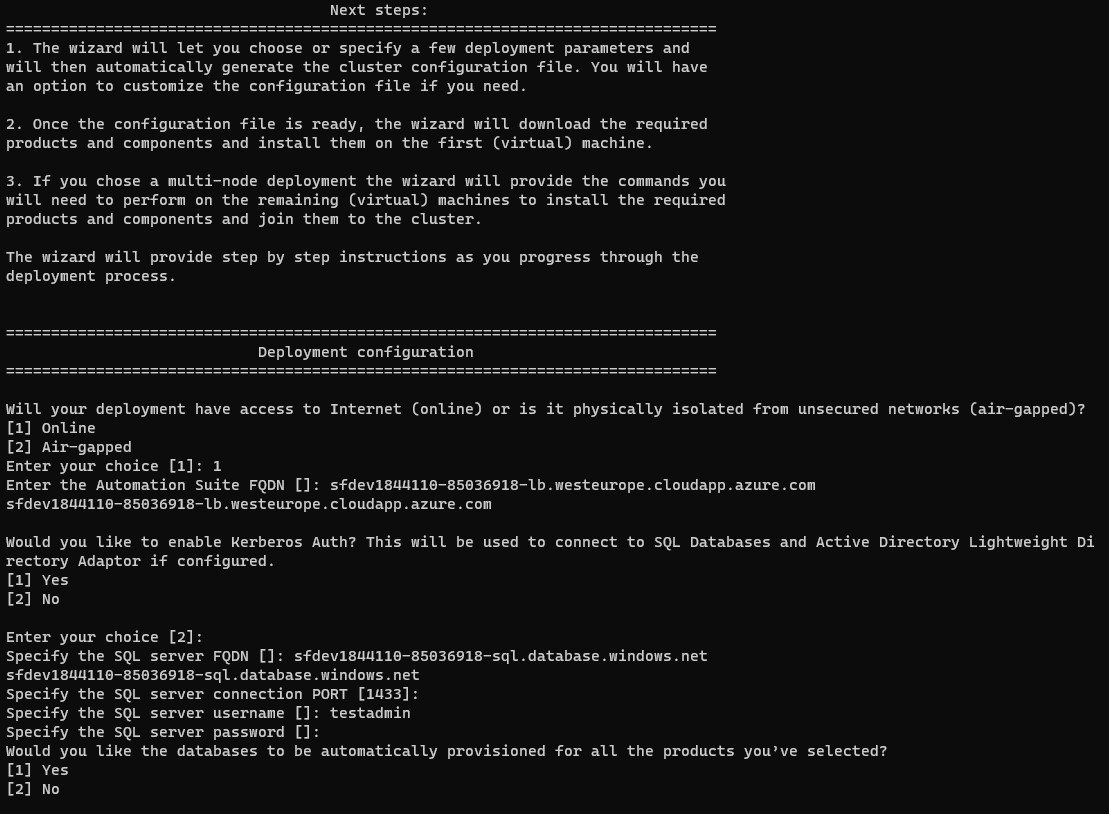

Step 3: Configuring the installation
3.1 Use interactive wizard to create base config file.
Note
Make sure to not start the install from the script and exit it when config file is generated, it will try to install full Automation suite otherwise.
Start interactive wizard using the commands below.
Note: This script is primarily used for Automation Suite and the displayed information (products, requirements) is relative to Automation Suite. The config file will be adapted to our needs in the next steps of the procedure.
cd /opt/UiPathAutomationSuite
chmod +x ./installUiPathAS.sh

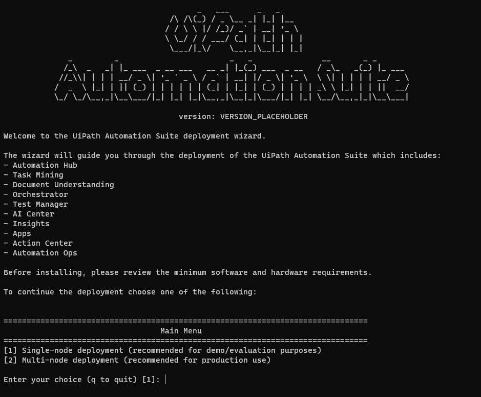

Screen-by-screen sequence
Upon starting the installation wizard, the main menu is displayed. From this menu you need to choose the desired deployment mode: single-node or multi-node. You are prompted with details about each mode once a choice is made. After that, you have the option to continue with the current choice or go back to the main menu.
Deployment configuration steps
  1. Accept the license agreement.
  2. Select the deployment mode: select the Single-node deployment option.
  1. Select continue.
  2. Select online installation.
  3. Select basic installation.
  4. Enter the DNS hostname.
  5. Specify whether you want to use Kerberos Auth for SQL connections.
  6. Enter the SQL Server URL. Follow the prompt to enter the connection port, username, and password.

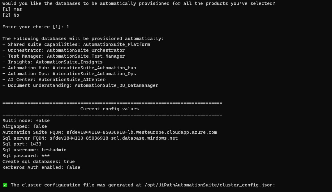

  7. Specify whether you want the installer to automatically create the necessary databases.
The cluster configuration file will be generated with a folder as shown in the following image.
Note: As soon as you generate the configuration file and the folder, you can exit the wizard and proceed with the remaining steps below to complete installation. You can ignore the list of products as we will update this in the following steps.
A first version of the cluster_config.json file is now generated. We will update this file to the purpose of the AI Center installation.
