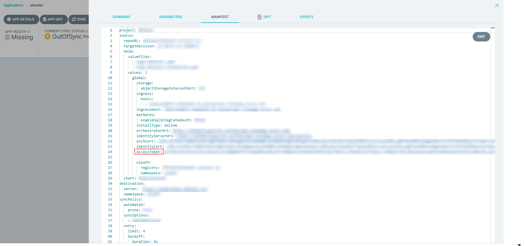

Expired identity token
Description
In some cases, when the AI Center installation takes more than an hour (usually during airgapped installations), the initial Orchestrator token supplied in the input.json file will expire and the AI Center registration with Identity Server fails. Follow the steps below to recover it.
Recovery steps
  1. Log in to https://alm.<LB DNS> using the admin username. To obtain the password, run the following command:
kubectl -n argocd get secret argocd-admin-password -o jsonpath={.data.password} | base64 -d
  1. Go to ArgoCD and click on the aicenter tile.
  1. Click APP DETAILS and go to the Manifest tab.
  2. In the Manifest tab, click Edit.
  3. Obtain the new identity token by updating the accessToken field in the Manifest tab and click Save.
Synchronization starts automatically and is completed.
