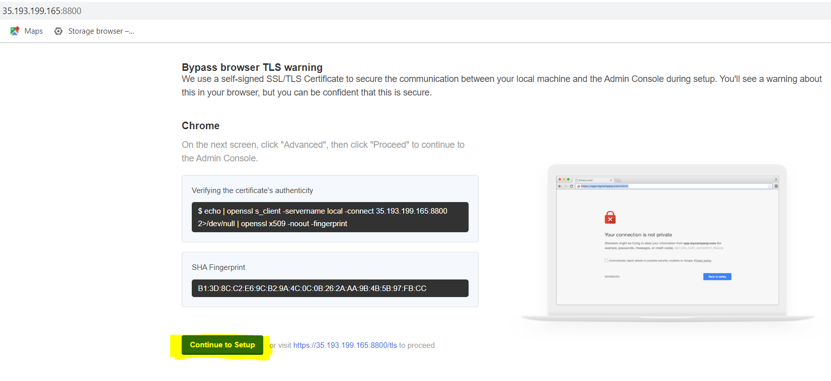

Accessing the Admin Console
Navigate to the admin console, this will always be https://<machine-ip>:8800. This is where the configuration for the application installer will take place. On navigating to that address, the below page is displayed.
Click Continue to Setup.

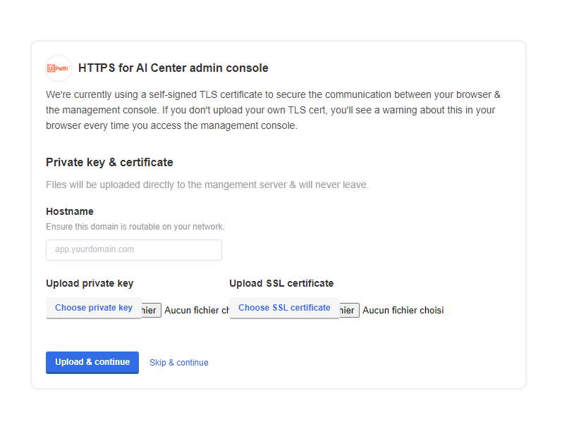

Configure DNS (optional)
We strongly recommend using DNS only with trusted certificates. If choosing to proceed with self-signed certificates, make sure that the certificates are trusted by the machines in your network.
Accessing this page
If the below page is not appearing automatically and you want to configure specific DNS/certificate you can access this page at the following url
https://< machine-ip >:8800/tls
The format of the certificate is a .pem file, and the private key is a .key file. The files can be obtained from the .pfx certificate.
If the Linux machine has DNS configured and you with to use your own certificate when accessing AI Center app based on a fully qualified domain name, this configuration screen will allow you to do so.
Enter the hostname and upload both the private key and the SSL certificate. Make sure that the domain is reachable from the network where you want to access AI Center over the ports 8800, 31443, 31390.
