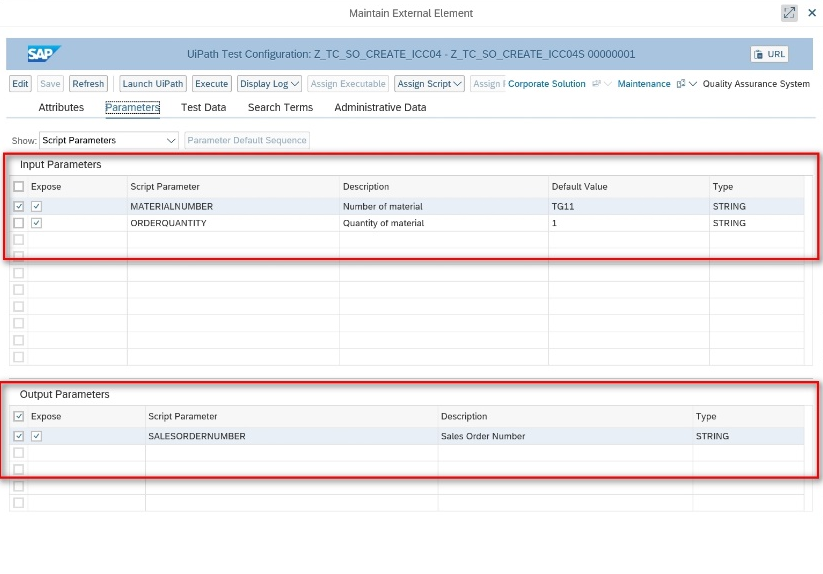

  7. Go to the Arguments tab and create two Input arguments to dynamically fill the right test data during the execution within Solution Manager. You can use these arguments to replace the Material and Quantity hardcoded values.
  8. Create an Output argument for the Sales Order Number to provide it to the following test case. You can get the Sales Order Number from the status bar.
  9. Right-click on the project and click Set as Publishable to prepare for publishing.
  10. Click Publish to publish the project to Orchestrator. The test parameters are now available in the test configuration.
