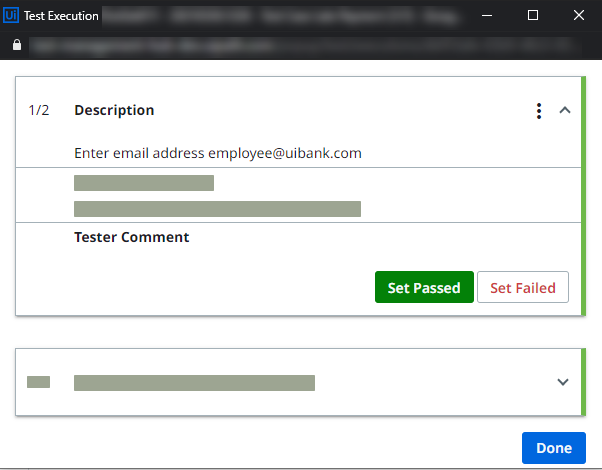

Copying Clipboard Values
When you add steps to a test case, you can enter any string value (e.g. {CLIPBOARD}) in the Clipboard data field.
587
During execution, a pop-up window shows the test case execution steps. The string value has been replaced by the Clipboard data value and placed in the Windows Clipboard.
602
