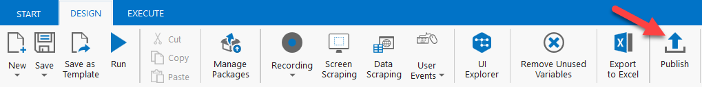

This can be easily done by using the Publish button on the Design ribbon tab. Please note that automation projects cannot be published if the project.json file is located in a read-only location.

To publish an automation project:
  1. In Studio, create a new project.
  2. In the Design ribbon tab, click Publish. The Publish Project window opens.
