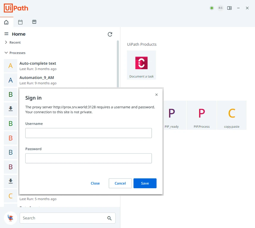

User mode robot
When the robot is installed in user mode, the UiPath Assistant automatically detects that a basic authentication proxy configuration is in place on the machine and prompts the user for a username and password.
