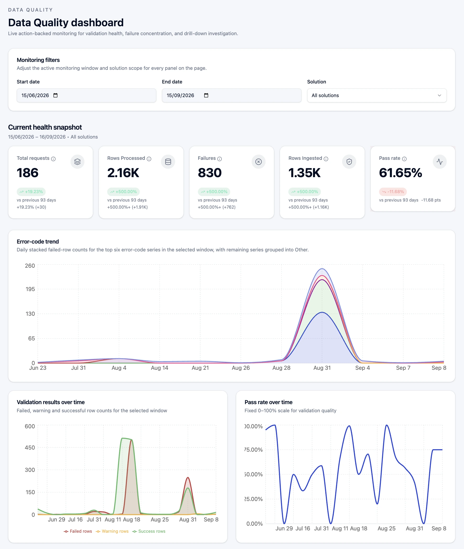

The dashboard is a single scrolling overview page, plus a table-level detail view you reach by drilling into any table. Every panel on the overview responds to the filters at the top.
Monitoring filters​
A filter bar scopes every panel on the page:
  • Start date and End date — set the monitoring window. All KPIs, charts, and tables are calculated for this window.
  • Solution — focus on a single solution, or leave it on All solutions to span the whole tenant.
Period-over-period comparisons on the KPI cards are measured against the immediately preceding window of equal length — for example, a 93-day window is compared with the previous 93 days.

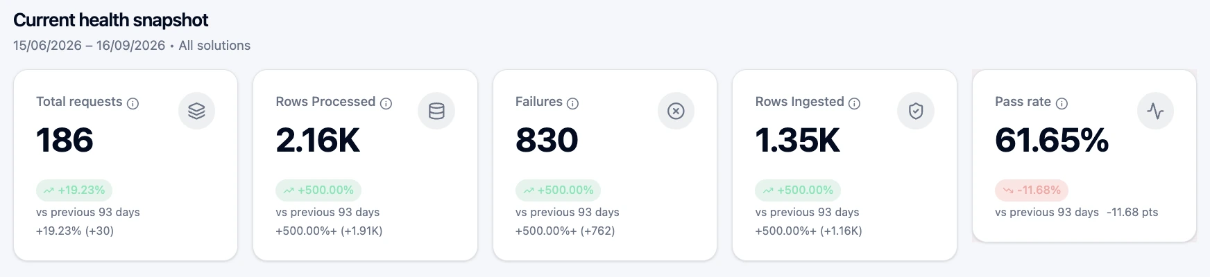

Current health snapshot​
Five KPI cards summarize the selected window. Each card shows the headline number plus how it has moved versus the previous, equal-length window:
  • Total requests — number of ingestion requests received.
  • Rows processed — total rows seen across those requests.
  • Failures — rows that failed validation.
  • Rows ingested — rows that passed validation and were written to the destination.
  • Pass rate — share of processed rows that passed validation.
A row kept in a table with a flagged foreign-key violation does not count as ingested. It counts under Failures when the check's severity is error, and as a warning when it is warn — so enabling the check lowers the Pass rate for tables that have unresolved references. Clearing the violation returns the row to the passing count.
Charts​

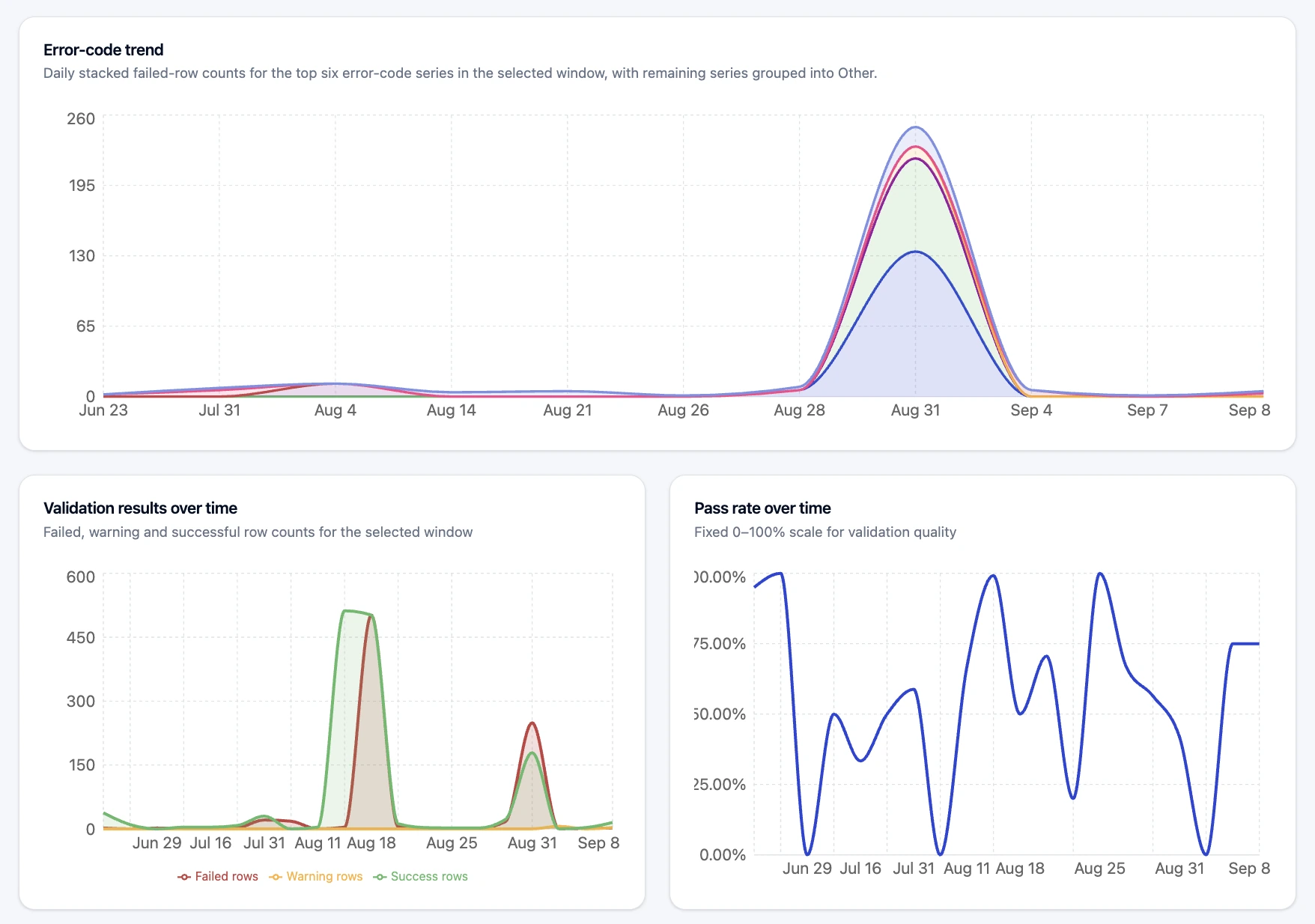

Three time-series charts plot trends across the selected window:
  • Error-code trend — daily stacked failed-row counts for the top six error-code series, with all remaining series grouped into Other. Shows which error codes are driving failures, and when.
  • Validation results over time — daily failed, warning, and successful row counts side by side.
  • Pass rate over time — pass rate on a fixed 0–100% scale, so quality is comparable across windows.

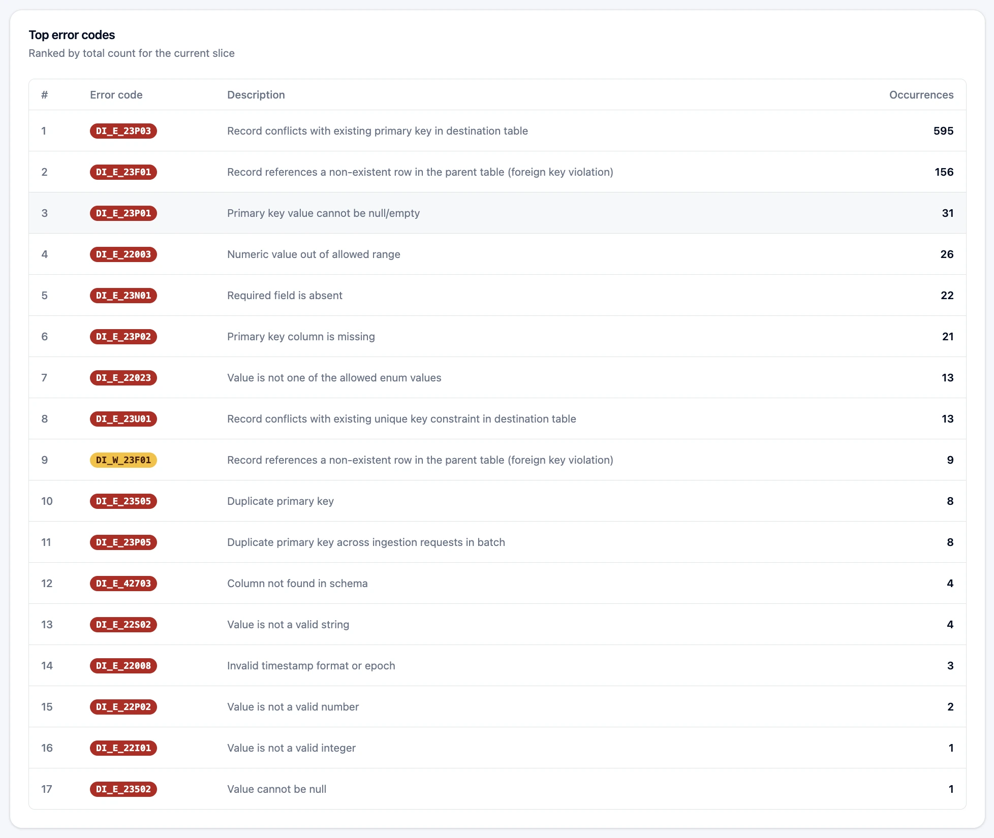

  • Top error codes — error codes ranked by total occurrences in the window, each with a plain-language description (for example, DI_E_22023 — Value is not one of the allowed enum values). Use it to find the most common data-quality issues to fix at the source.

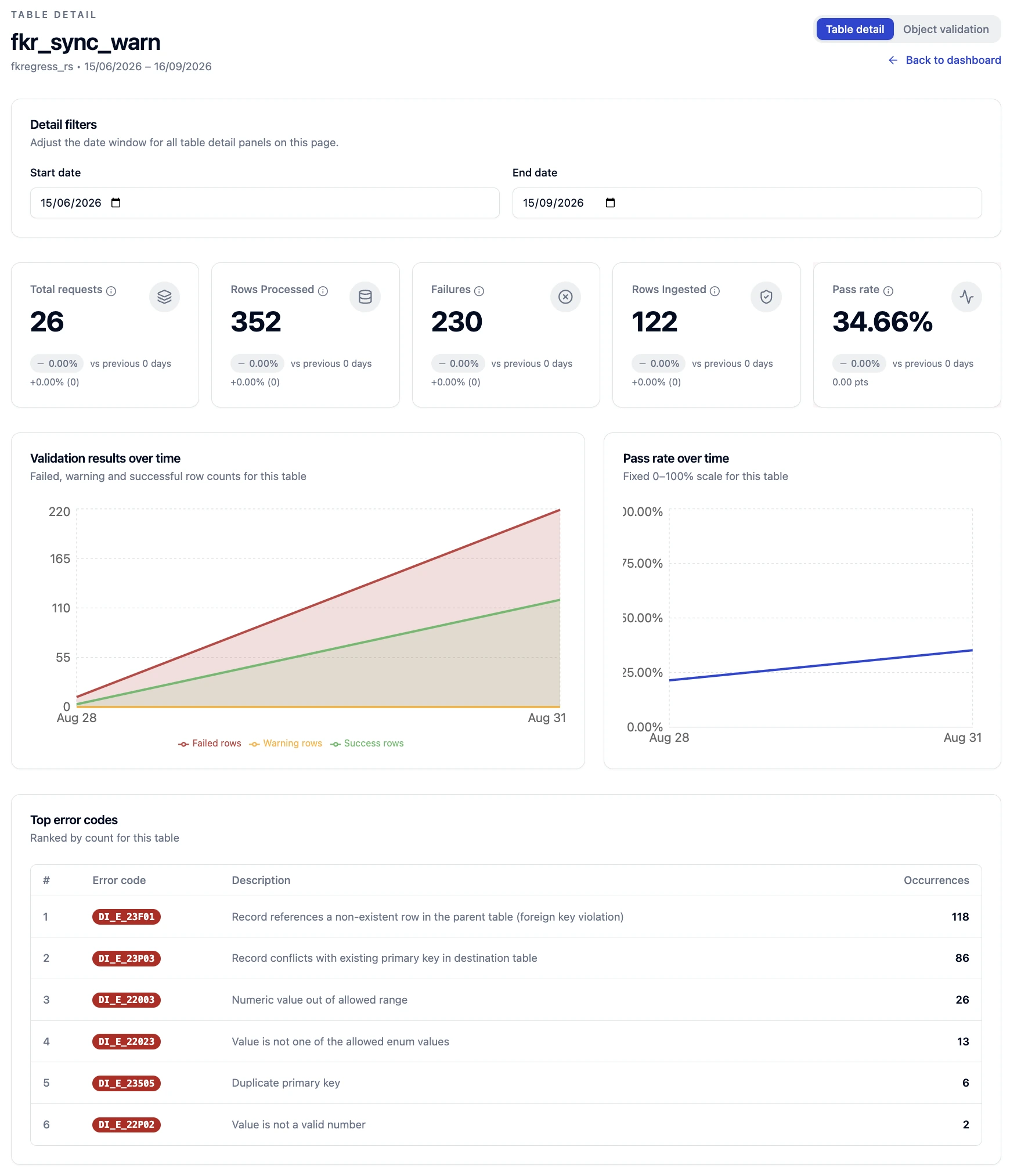

Table detail​
Selecting a table name in Breakdown by table opens a detail view scoped to that table, solution, and date range. It lists the failed rows for the table, including the source field values that caused validation to fail, so you can reproduce and fix them. Hover any error code to see what it means.
The page header's Table detail and Object validation tabs move between the row-level view and the table's object-validation results without losing the selected table and window.

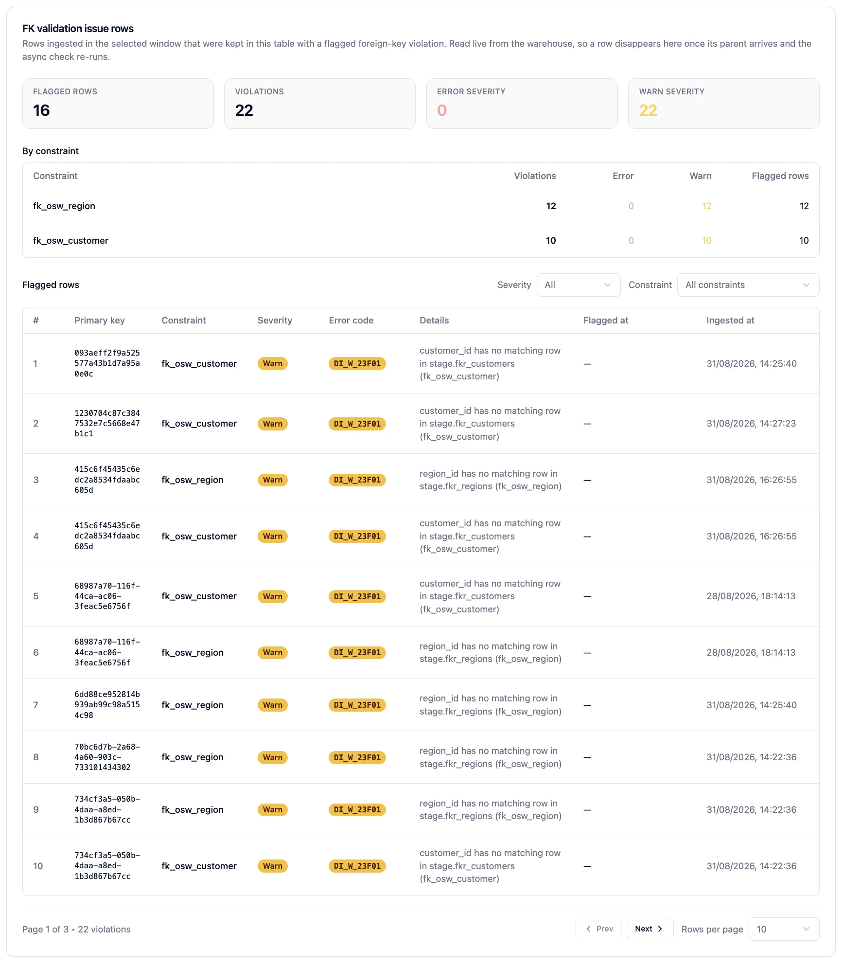

Table detail — foreign-key issue rows​
FK validation issue rows lists the rows that were kept in the table with a flagged foreign-key violation. The panel reads the table's live PEAKAUDITERRORS column, so a row leaves the list once its parent arrives and the next async_foreign_key run clears the flag.
Three parts make up the panel:
  • Count cards — Flagged rows, Violations, Error severity, and Warn severity. Flagged rows and violations differ when a row breaks more than one constraint, since every violation is counted separately.
  • By constraint — one row per foreign-key constraint with its violation, error, warn, and flagged-row counts, so you can tell which reference is causing the backlog.
  • Flagged rows — the rows themselves, paginated: Primary key, Constraint, Severity, Error code, Details (for example, region_id has no matching row in stage.fkr_regions (fk_osw_region)), Flagged at, and Ingested at. Severity and constraint filters narrow the list.
Flagged rows also appear in the row-level Error-code trend and Top error codes panels under DI_{E|W}_23F01. The panel is shown for every table that carries the foreign-key audit columns, and reports that no rows are flagged when the table is clean.

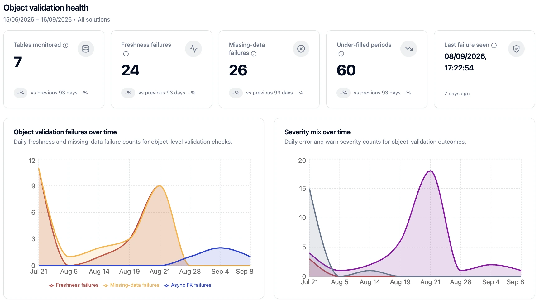

Object validation health (overview)​
Five KPI cards summarize the selected window across every monitored table:
  • Tables monitored — tables that have at least one object-validation rule.
  • Freshness failures — number of freshness-rule failures (DI_*_24F01).
  • Missing-data failures — number of missing-data-rule failures (DI_*_24M01).
  • Under-filled periods — total individual time windows that came in below their expected row count.
  • Last failure seen — timestamp of the most recent object-validation failure.
Two charts plot the trend across the window:
  • Object validation failures over time — daily freshness, missing-data, and async foreign-key failure counts.
  • Severity mix over time — daily error and warn counts, so you can see how serious the failures are, not just how many.

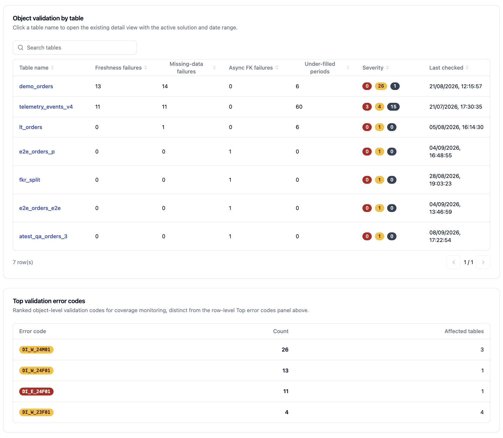

Object validation by table​
One row per monitored table, each with its freshness failures, missing-data failures, async FK failures, under-filled periods, a severity breakdown (error / warn / failure counts), and last checked time. The list is searchable and sortable. Selecting a table name opens its object-validation detail view, scoped to the active solution and date range.
Below it, Top validation error codes ranks the object-level codes (for example, DI_W_24M01, DI_E_24F01, DI_W_23F01) by count, with the number of affected tables — kept distinct from the row-level Top error codes panel higher up the page.

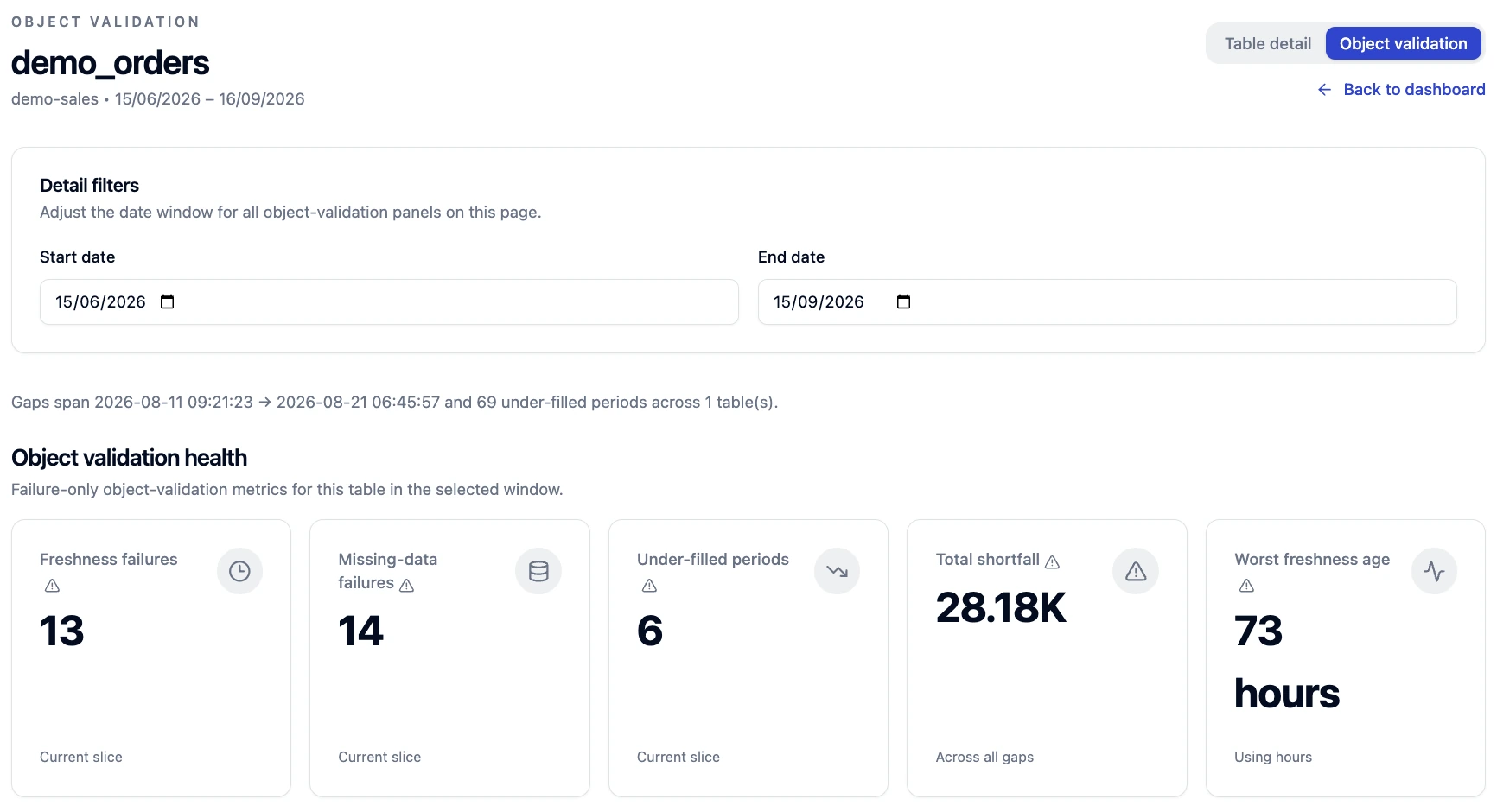

Table detail — object validation​

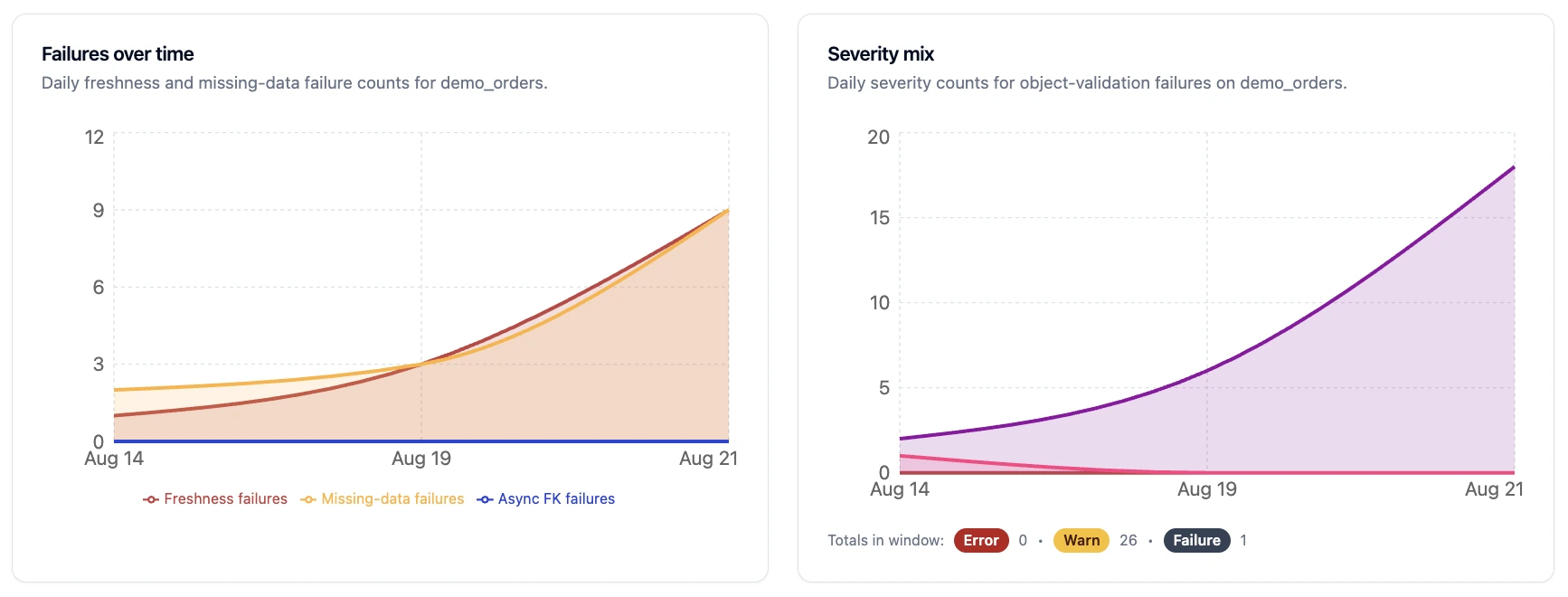

Selecting a table opens its object-validation detail page. A Detail filters bar sets the date window for every panel on the page, and a summary line reports the span of the gaps and the number of under-filled periods across the table.
Object validation health cards summarize the table in the window:
  • Freshness failures, Missing-data failures, Under-filled periods — current-slice counts.
  • Total shortfall — expected-minus-actual rows summed across all gaps.
  • Worst freshness age — the largest observed staleness for the configured column.
Two per-table charts — Failures over time and Severity mix — plot the same trends scoped to this table.

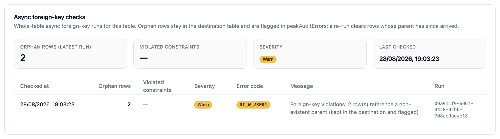

Async foreign-key checks​
Async foreign-key checks reports the whole-table async_foreign_key runs for this table. Four cards summarize the most recent run — Orphan rows (latest run), Violated constraints, Severity, and Last checked.
Below them, one row per run lists its Checked at, Orphan rows, Violated constraints, Severity, Error code, Message, and Run identifier — confirming that a run happened and what it found. The flagged rows themselves are listed in the FK validation issue rows panel on the table's row-level detail view.
