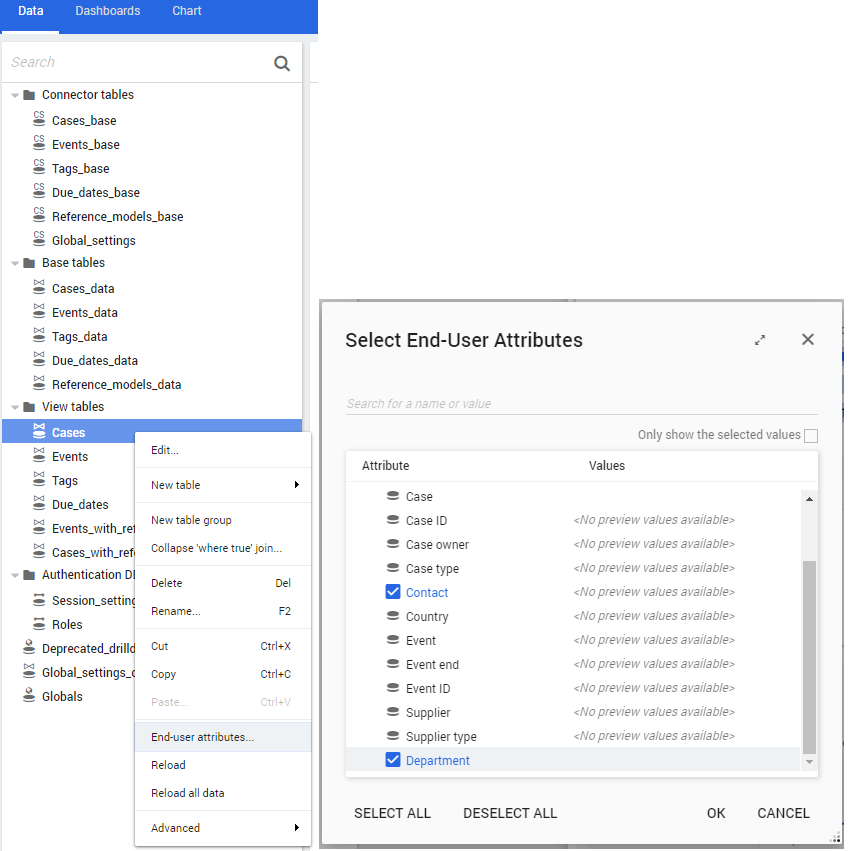

Adding attributes to the End-user filters
You can also add the new attributes to the list of End-user filters that are available to end users from the Filters panel. To do this, you must add the new attributes to the End-user attributes of the table they are in.
Follow these steps to make the attributes available as End-user filter.
StepAction
1Go to the Data tab and right click on the Cases or Events table in the View tables folder.
3Select End-user attributes from the context menu.
4Select the new attributes you want to add to the end user filters. See illustration below.
5Click on OK (2x).
851
